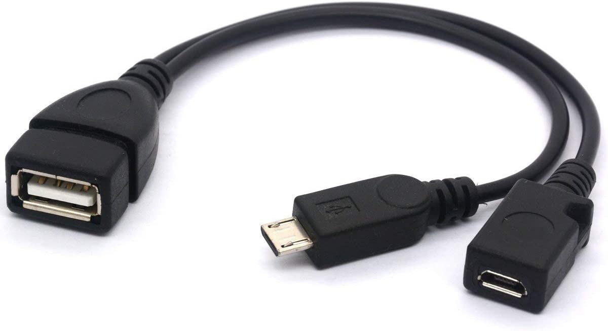

Well - I'm glad @neonturbo inquired about your location. The adapter cable will look like this:
I don't know what the USB z-wave dongle for Europe looks like.
