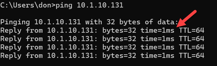

The response times are way high on the hub. Should be 1ms for the most part.
