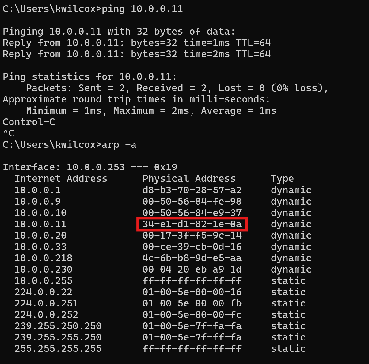

Does it respond to ping? You may have a duplicate IP address. If you have a Windows, Mac or Linux machine on the same network (probably 192.168.0.0/24), open a command or terminal window, do the ping test then immediately after do an "arp -a". Find the entry for 192.168.0.55. Does the MAC address match the one printed on the bottom of your hub? Here's an example on windows using my hub whose address is 10.0.0.11:
If you aren't getting a response to ping, you should still try the ARP test to see if the hub (or some other device) is responding to ARP. If its the hub, then you have a hub issue, otherwise you most likely have a network issue

Good idea - Thanks. on my Mac - ran Terminal - arp -a
The MAC address on the bottom of the Hub does not match ANY of the addresses that are displayed. The Hub is Ethernet connected directly to the router. I am going to reboot the router.
