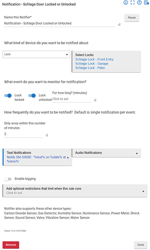

@bertabcd1234: Here is a snapshot of my Notification App setup:

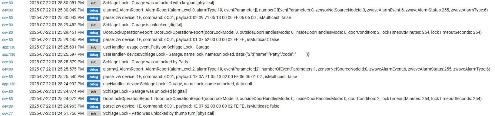

Here is a short dump from my events log:
As you can see, the information I'm looking for is out there. Note the "info" events at 01:24:51.756 PM (Patio was unlocked by thumb turn [physical]) and 01:25:25.579 PM (Shlage Lock - Garage was unlocked by Patty).

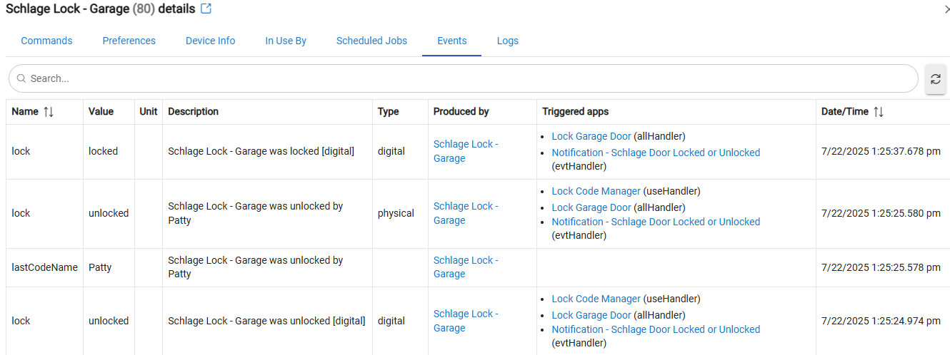

I was looking for Events for the lock device, not Logs (both are often helpful, but Events is what would show the exact data we're looking for in this particular case).
Here you go - Schlage keypad events for the same time period:
Does your notification output really only include the attribute name, like "lock was locked"? From your screenshot above, %text% should contain the device name since it's in the description text, which we can now see in your Events page screenshot.

That is under control of the driver, not the hub at large or this particular app. Specifically, it reads the descriptionText property of the event, which you can see in the "Description" column in your screenshot above. That is why I asked to see that particular page, as it has the exact data the app would also see.

This is promising, but do you only see one event for each? (Apps work from events, not logs, so again "Events" would really be the place to look -- though both can be helpful for troubleshooting.) Because the first should be "Lock" and the second "Lock Codes" in terms of the options in the Notifier app.
If you're seeing something else, you have duplicate-ish events (not surprising, as unlocking by a code also unlocks), but the question would be how to filter them out. Are you sure you weren't using a rule or something else previously, where you could use conditional actions based on the descriptionText or a similar approach?
