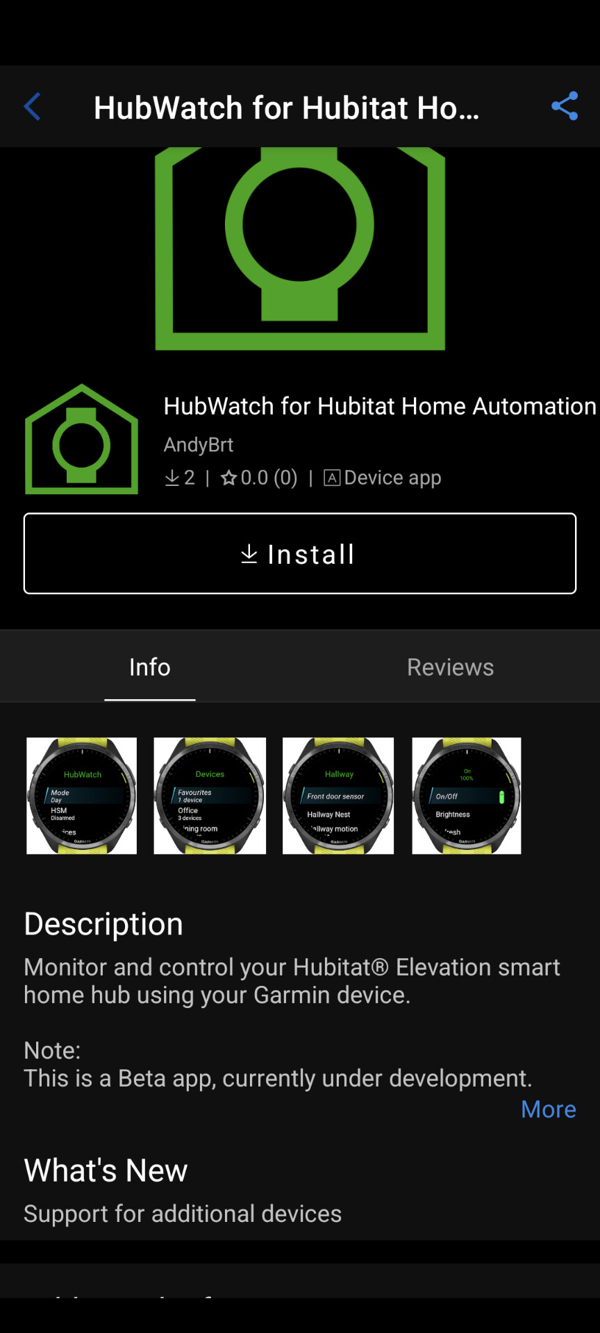

OK, the first beta version is now available in the Connect store.
https://apps.garmin.com/en-GB/apps/3f565d28-d7e6-40a5-97a3-2b62ac6ff8bd
Let me know how you get on.

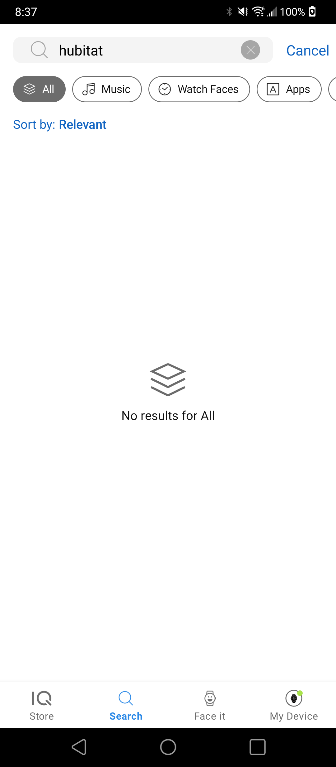

so far not showing in my search

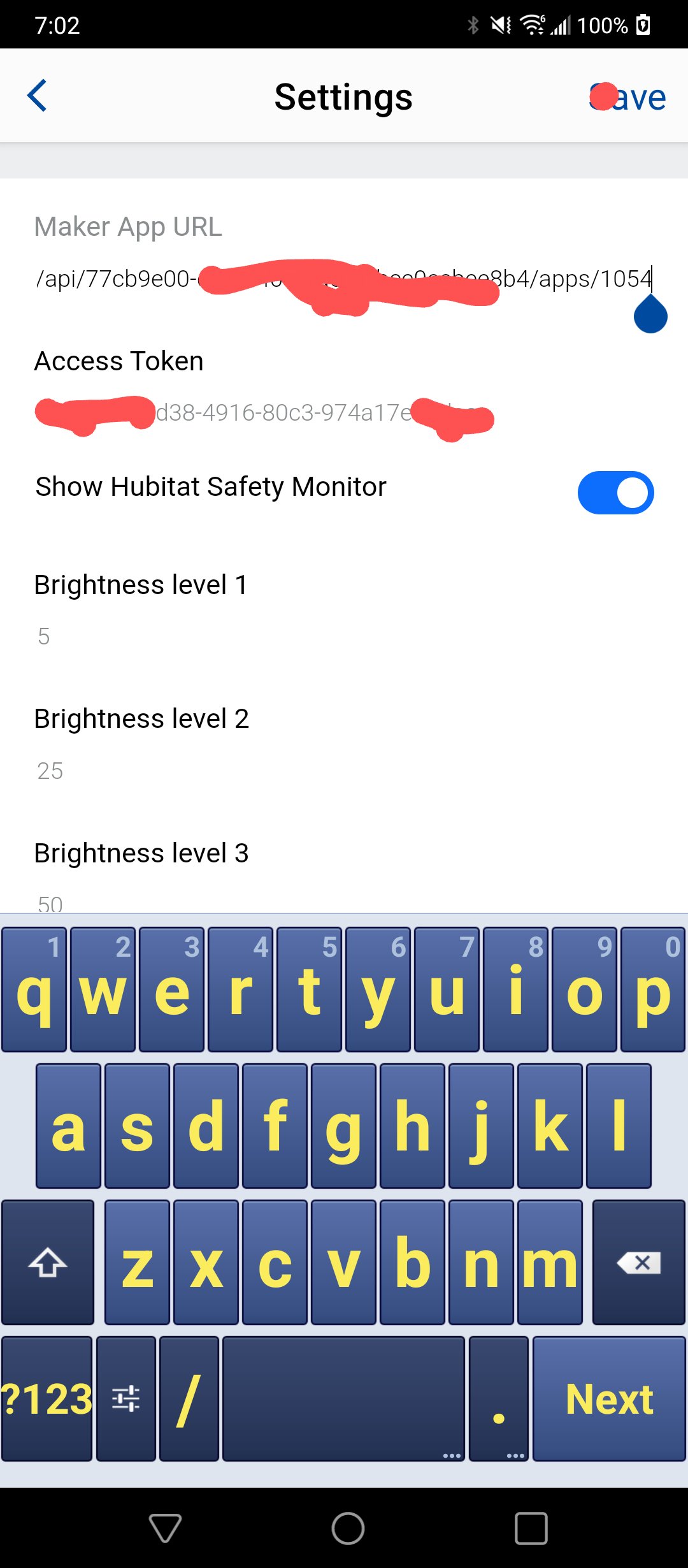

How long should I expect it to sign in? It takes forever unless I'm using the wrong URL
Ok, l'll add Fenix 7 pro.
It takes around a second or two.
Both the URL and token need to be correct (maybe I can add some more checking).
You need to use the cloud URL, rather than the local one.
Sorry about that. I've been busy with the day job and haven't had a chance to change it yet. I'll aim to update it tonight. I don't know how long the re-approval will take.
Ok found app thanks installed configured.
But app just hangs on conecting.
Nothing in hub logs from maker api.
Try adding a "/" at the very end of the URL, if there isn't one there already.
I assume it starts with "https://cloud.hubitat.com/api/..."
Thanks. That was it works now!!!!
Very happy to hear that. Shows I could do with adding some checking in the app.
