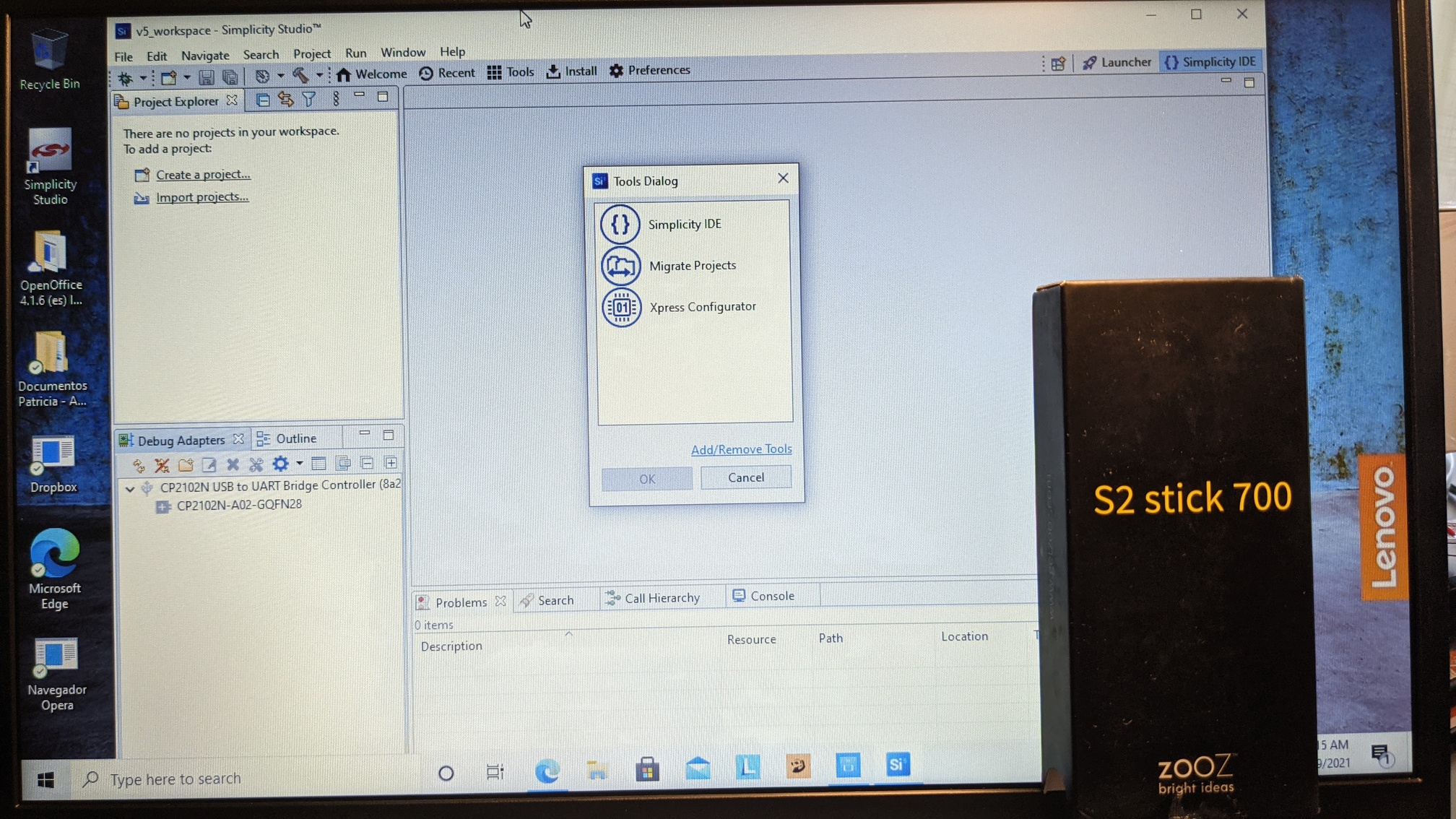

looks quite different on my "Simplicity Studio":
You might be using a newer version of the Sci Labs toolset. Click add/remove tools in the tools dialog, then click on the tools tab. Scroll down to the ZWave PC controller and install it. See if the instructions from that point on make sense.
Yep, @klenk that Ghost Removal document page 9 like I mention above covers this step.
I think it's the same - you are on the "{} Simplicity IDE" tab while
@neonturbo is on the "Launcher" tab - see upper right hand part of the app window.
Not the best UI design...
Clearly designed by engineers, for engineers :slight_smile:
