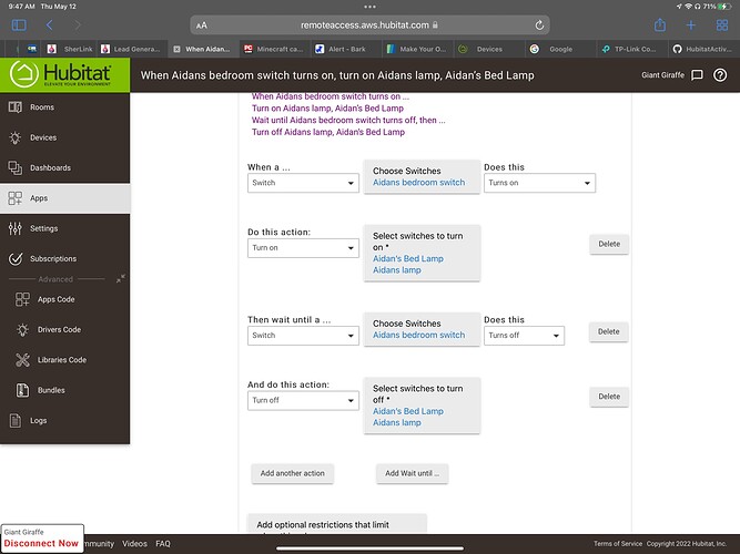

Ok, so in hubitat I have a basic rule,
I also have my hubitat hub linked to my Alexa and I have rooms and Lights set up, here is my issue. Since hubitat does not give us the ability to set a switch to on/off, it only has turns on AND turns off, If I walk into a room and “turn on” the switch it then turns on the lights, but if I say Alexa turn off the lights, the lights go off but the Switch does not, so in the morning when I walk back to the switch it is now off Hubitat’s rule because the lights are off but the switch is still on. So when I click it the switch it “goes off” now I have to wait and click it again, Turing the switch “on” so that the lights come on.

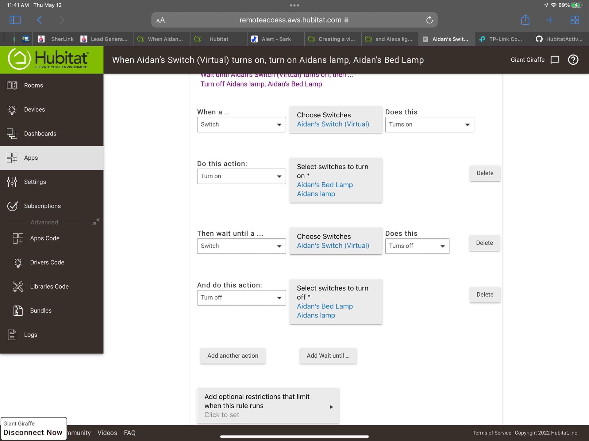

You need to create a rule that uses the virtual switch as a trigger to turn on those physical switches
Trigger (Virtual) switch
Action Turn on Light(S)
Like this?

Right. What you have above works. Now that virtual switch needs to be exposed to alexa through HE's alexa skill

The work around I did for this was to set a rule stating that when the desk light and the lamp go off, it will turn off the switch, now when he tells Alexa to turn off the lights, she will turn them off, HE will see the status change and change the switch to off,
