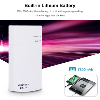

I had some eBay bucks to spend so I just ordered this for about $22.41. I believe it should work, but I'll let you know. (Be sure to pay in local currency, and let your credit card do the conversion, and use a credit card with no foreign transaction fee).
My experience with plug-in battery packs (such as this), is they do not switch over fast enough. While I did not test on an HE, which may have longer hold up, the device I did test against restarted when unplugging the battery from the wall.
Unless a device is explicitly described as a UPS, I suspect it will not have glitch free transition from wall to battery.

The GM322 is marketed as a mini-UPS and sold under other names as such. In its specification, the somewhat broken English says "Mini UPS can charge Router and light cat at the same time", which either means it transitions smoothly, or you can use it to make your cat glow.
There is this as well:
Just make sure you use the USB output. It appears the barrel jack output is 12v.
