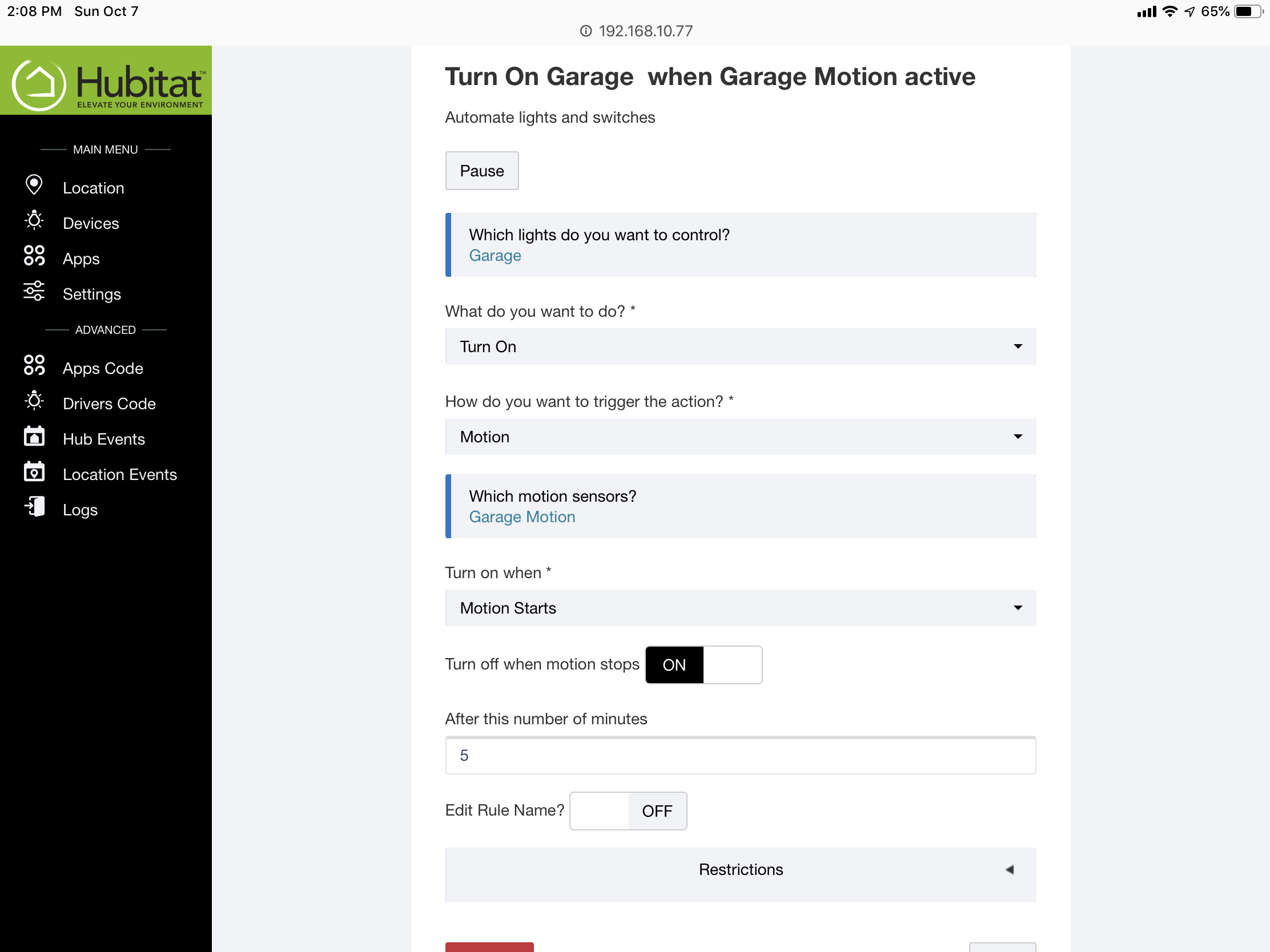

I have a simple lighting motion that worked perfectly on 1.1.4.126 and does not work on 1.1.5 first or latest. I even deleted the rule and redid it. Still doesn’t work. I rolled back to 1.1.4.126 and the rule again functions perfectly and instantly. It’s just one switch and a zosk motion detector to turn on the garage lights then 5 minutes of no motion to turn off the lights. It’s been running fine since day one of hub setup on every firmware till the 1.1.5 versions.
Could you show a screenshot of this rule? Simple Lighting was not changed in 1.1.5, but something else might be causing it.
Going back to the 1.1.4 and no other changes fixed it and it’s working. I may try to install the 1.1.5 latest if I have time later.
What brand/make of device is Garage?
I notice in your app status page that it has scheduled to turn off the Garage. Did it fail to come on? If so, it would seem that something is up with that device, as it must have responded to the motion sensor going inactive to schedule "doAntiAction".
It’s not fixed with a re update
The device is a aeon wall switch which is activated by a motion detector. Motion in garage returns on overhead lights, 5 min of no motion turns the lights off. If I roll back to 1.1.4 I’m fine. Update to 1.1.5 and it doesn’t work the motion registers, I can operate the light from the dashboard, but the motion doesn’t turn on the light.
