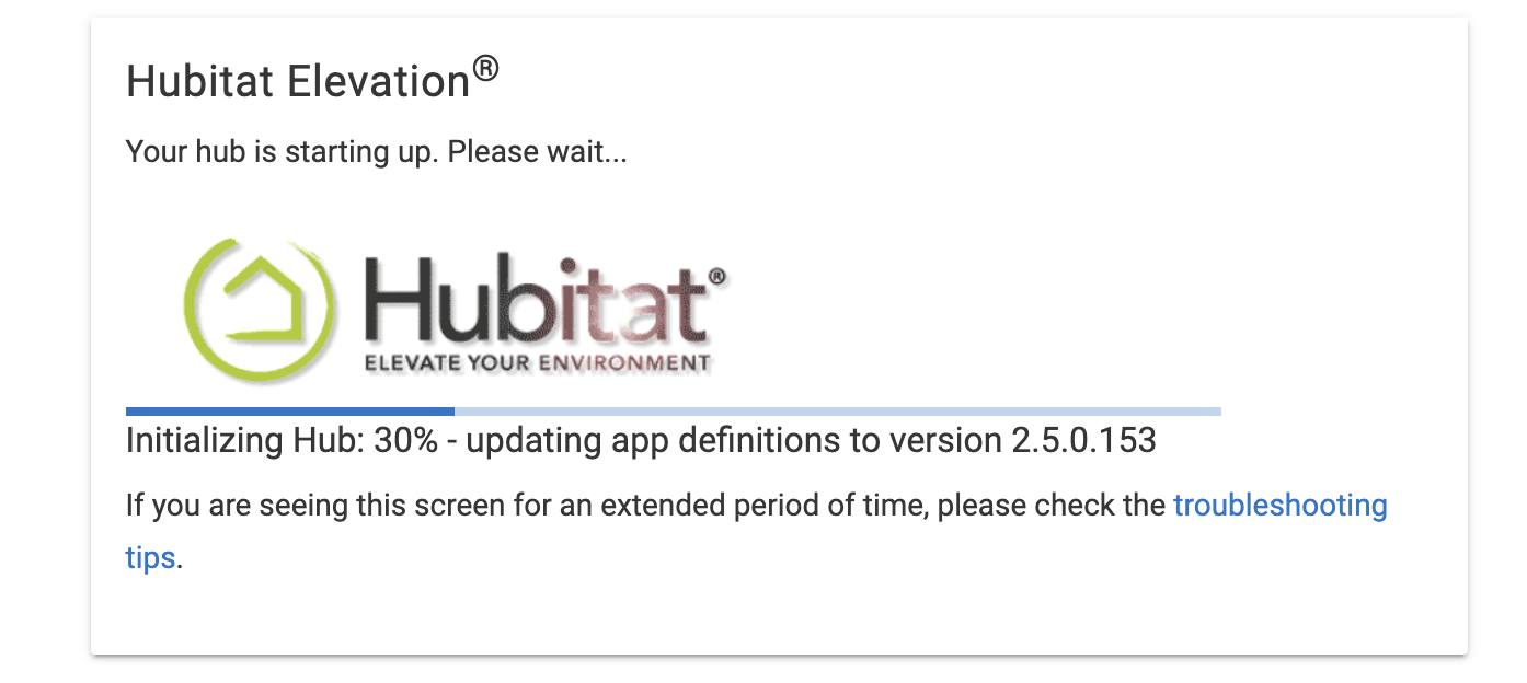

I should have left well enough alone. So far stuck at the same place again!
How long has it been? Just wait and don't do anything. Go for a walk.
I let it sit over night. No movement past “Initializing Hub: 30%“

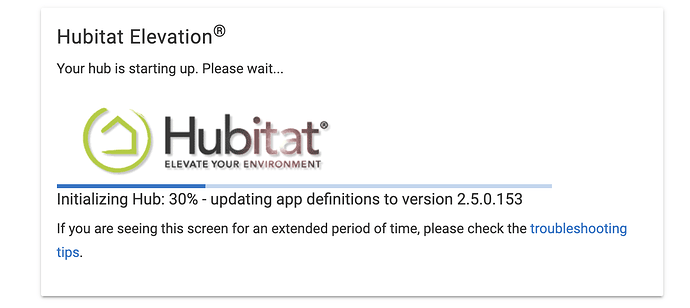

Please forgive the delayed update. I found a fix and wanted to report back with the exact steps that finally broke the loop on my C-7, just in case anyone else hits this same wall.
I tried the new platform version as suggested, but it immediately triggered the exact same 30% initialization freeze. Here is the specific sequence that finally got me sorted out:
