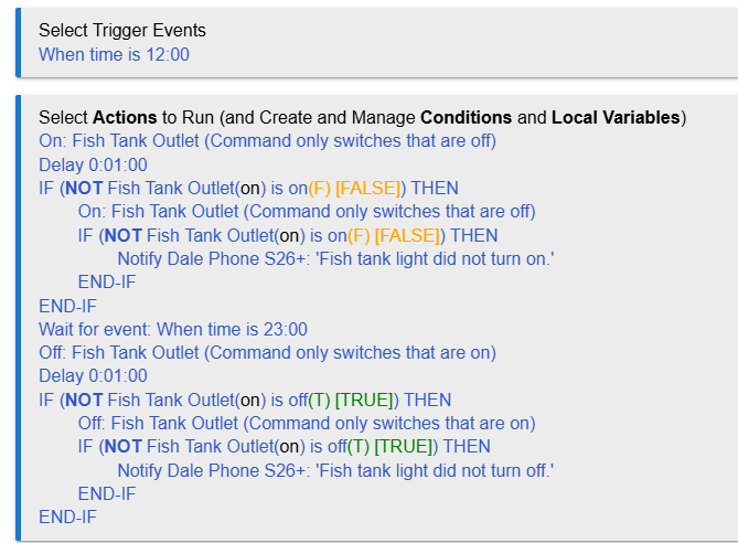

Here is the fish tank light rule.
Heater code
Having seen this rule, I strongly recommend breaking this into two different ones for On and Off. You are basically asking the rule to wait 11 hours which can sometimes cause problems. If you really wanted one rule, have it triggered at both 12 and 23. It would look something like:

For the light one, I would absolutely either split it into two rules, or run with two triggers and logic for if it is one time or the other.
This is what I ended up doing with the fish tank light. On the other fish tank suggestion I did not see that you could have an IF statement for a specific time, only between two times. For the heater suggestions, I will have to wait for the heating season to try those sugestions.
