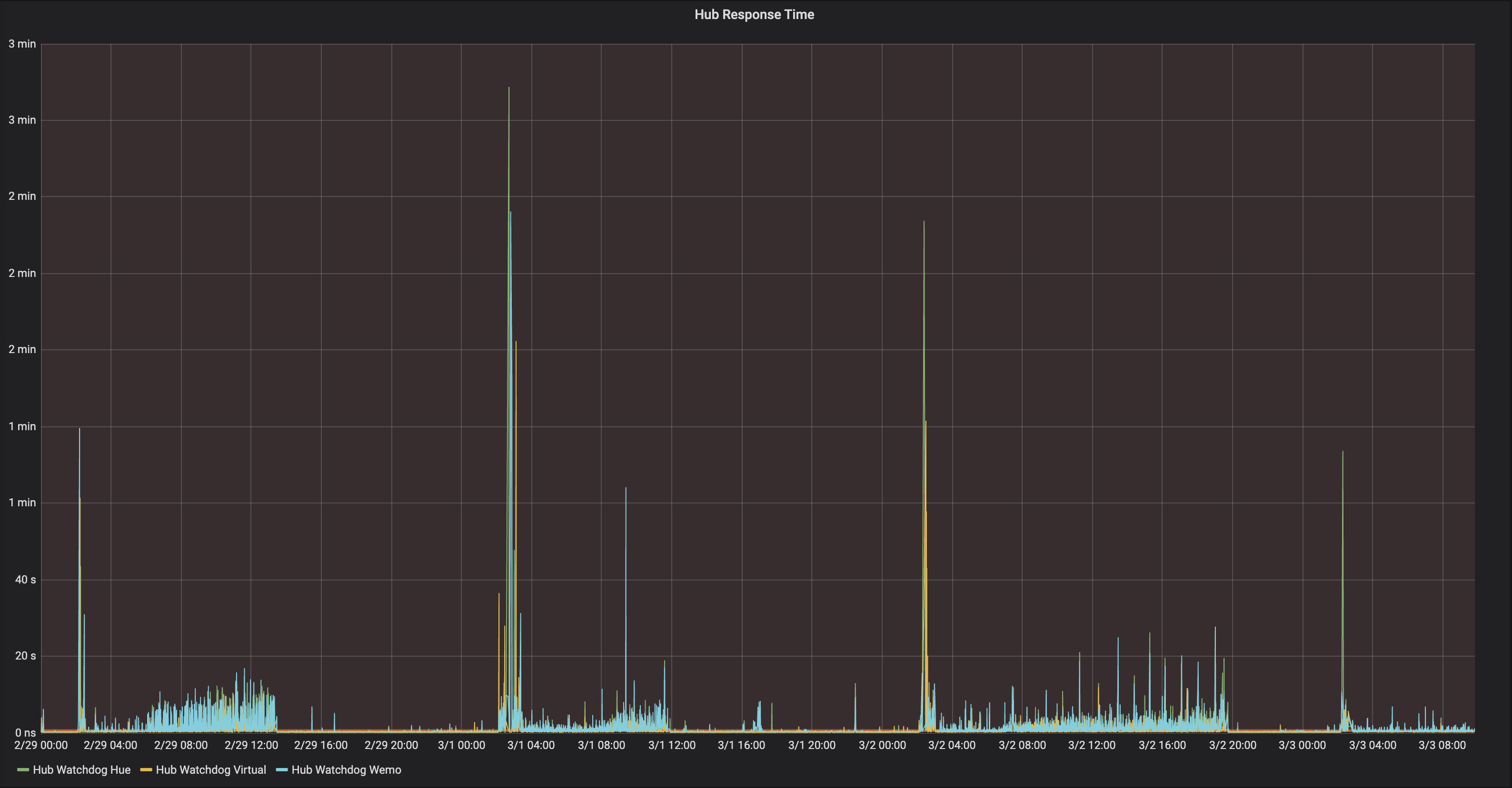

I've been monitoring my hub response using @bptworld's Hub Watchdog and have found that my hub slows down every morning just after 2am. I don't know what causes my hub response time to spike, but I do know that the hub doesn't really recover from the event and becomes less responsive over time until I reboot it. You can see where the response times drop back to pretty much a flat line, which was after I rebooted the hub.
I've looked through all my devices and apps and none of them have a daily scheduled task around 2am. I'll continue monitoring the situation and hope to pin down the cause of these issues. Let me know if anyone has clues about the 2am spikes.
That’s the database maintenance time
Yea that is the DB maintenance time...but it is a pretty clear pattern that the hub slowly continues to get slower right after maintenance. After the reboot it stays pretty flat until maintenance happens again..then starts slowing down. I call that a very interesting find!
