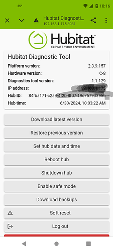

Can you get to the Diagnostics Menu (http://<yourHubIP>:8081)?
I'm able to get there using the android app
Tried rebooting and soft reset . Restore now in process
Were you trying to update the hub right before you noticed the blue led? If that's the case, the first thing to try is to restore to previous version, then try to update again.

I tried soft reset and got a green light after I did a restore. The the hub auto reboot and the light stays blue.
Looks like it's back
I have a green light. Looks like it's working now. Remote are controlling the devices.
