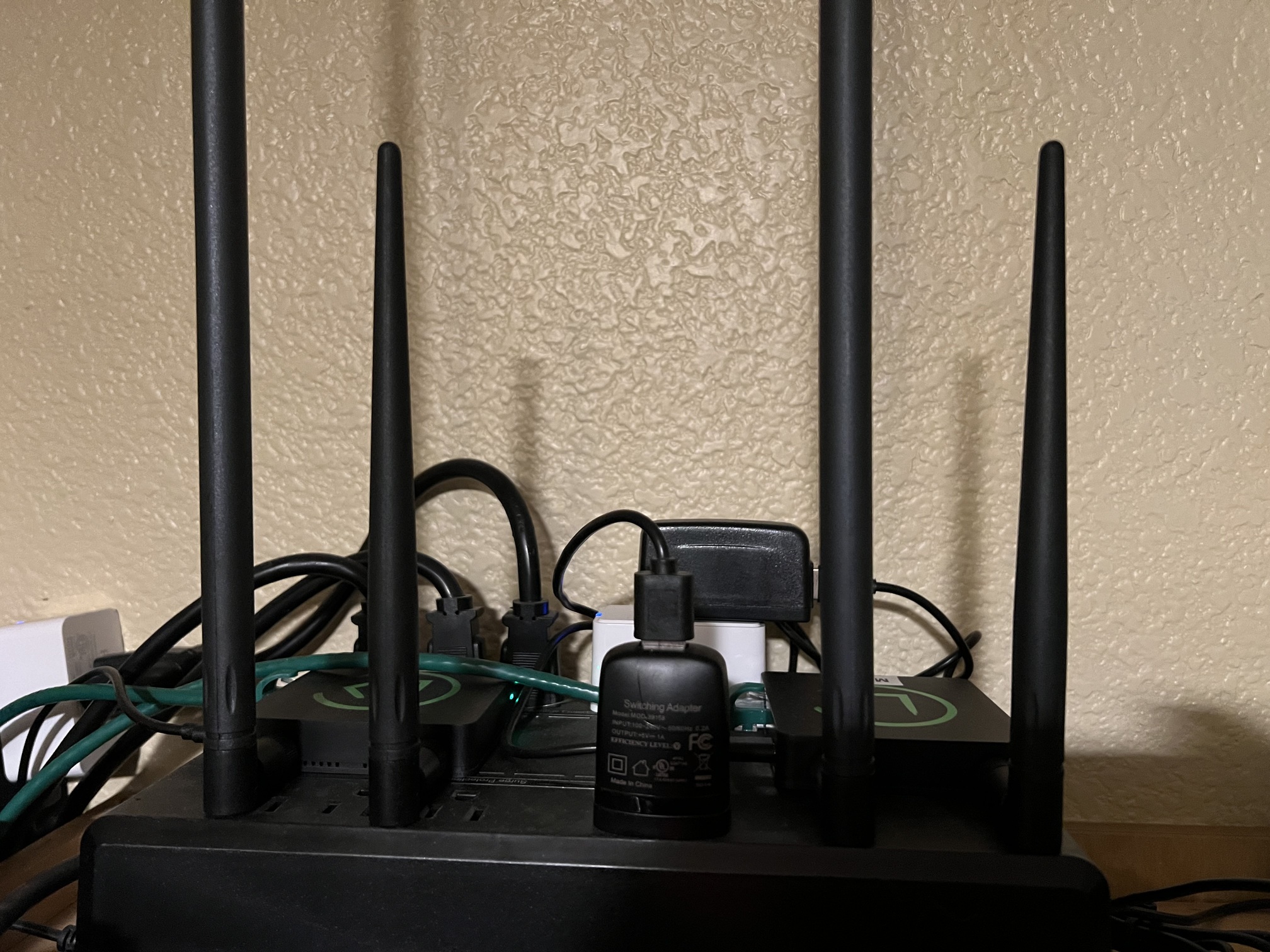

Here is what my setup looks like now…

Yes that was me. I also used my c7 L-com antennas on my c8 pro and I couldn’t get Zwave devices to pair but all existing devices from the migration worked great. The c8 doesn’t like that 5db antenna, long one that I see in your picture which is also what I had. Stock antenna works just fine but I needed an antenna with a hinge so I could mount the hub on a wall with both antennas pointing straight up so I bought the 3db one and it works too.

Antennas and their placement appear to have a very real affect on how the hub adds devices...
I did some reading and decided to try the antennas @danabw uses. His post from another thread is below...
In any event, I was able to pair two LR devices to my backup (clean) hub! As a reminder, I was using antennas from my C7's from back when we did the antenna mods on them... I was using the l-com 5db...
Anyway, I bought four of them and hooked them up to both hubs. Still can't add LR devices on my main hub as that probably needs a z-wave reset, but on the backup hub, it worked like a charm... I'm going to play a little more, but I also noticed improved connectivity with my main hub and mesh devices...
Justin putting it out there to the world, if you are having issues, might consider some antenna changes... BTW, the 5db antennas seemed to work great for my mesh, but just wouldn't include LR stuff... These new ones seem to work great for my zigbee devices also... Only about 12 hours in, so I hope this will hold...
