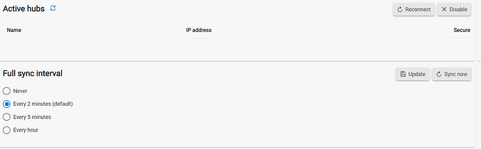

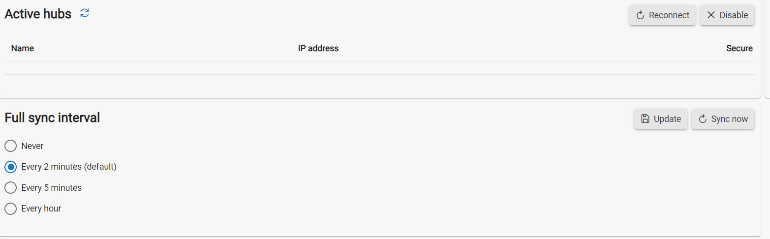

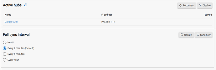

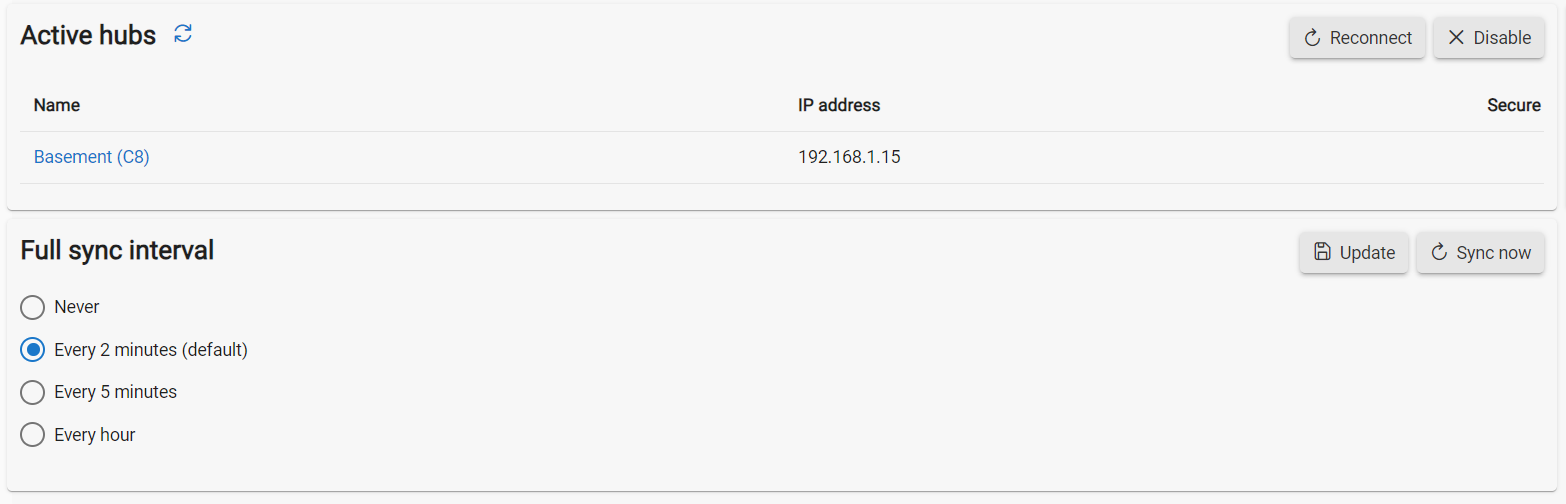

My mesh does not consistently connect between the hubs. I have three hubs... Reasonable distance between the hubs, thus the need for three. Unfortunately, every few days one or all three hubs will stop talking to each other...which kills the Google home integration. Any suggestions?
Currently using 3 C8 hubs
All on the same version: 2.3.5.152
All connected via ethernet - all on assigned IP addresses from the router (not Hubitat)
Great Room Hub - constantly drops of the mesh network
Basement Hub - connects to the garage
Garage Hub - connects to the Basement
Biggest use for me is the Google home integration...unfortunately, I don't know of a way to have all three hubs connected to google home.

When you say they drop off the mesh network, are you referring to the device updates no longer coming through in HE, but you are able to access the HE hub web UI? Or are they dropping off your LAN altogether, i.e. you can't even access them via the web UI? The main reason I ask is because the first hub you showed the screenshot for doesn't appear to have any hubs listed that it communicates with. Or was this just to illustrate the point that it disconnects regularly?
Hubs are not connected on the hubmesh, but are still on the network.
