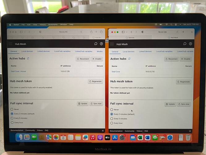

Morning
I have both hubs set up. And I can see them connected to each other in the setting / hub mesh main menu. I have shared devices across to each other ( can see them listed in the linked devices ) under the linked devices tab but I can’t see any of the linked devices when I try and select them in a dashboard.

Only those devices that are shared across the hubs. They'll show up under the Linked Devices tab from the screen you're at.
Click the + symbols to actually Link the devices. Right now, they are showing as available to be linked between the hubs.
