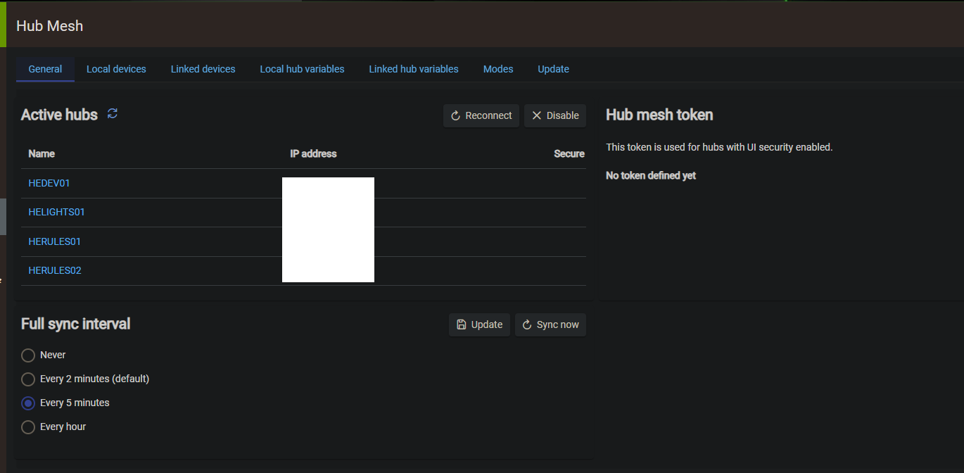

Hub Mesh works on all hubs but one
I have four hubs, Hub 1 is showing up in the General tab of the other three hubs.
I show devices from Hub 1 already linked in the Linked devices.
But when I share new devices on Hub 1 these devices do not appear under the available on Hub 1 section of any of the other three devices.
Have rebooted all hubs but can't figure out the new shared devices are not showing up?

Found the issue! I have the Home Assistant Device Bridge app running on the Hub 1. At some point in the past I had shared this device and it has hundreds of children representing devices that I use from Home Assistant.
I never actually used this device on the other hubs as I centralize most of my rules on Hub 1.
So I was in the process of setting up a test device and sharing it and noticed this device. So on a hunch I unshared it thinking the number of devices was overwhelming the mesh - or timing out or similar.
And sure enough all of the devices shared on Hub 1 miraculously appeared in the other hubs.
Thanks to all for helping me resolve!
