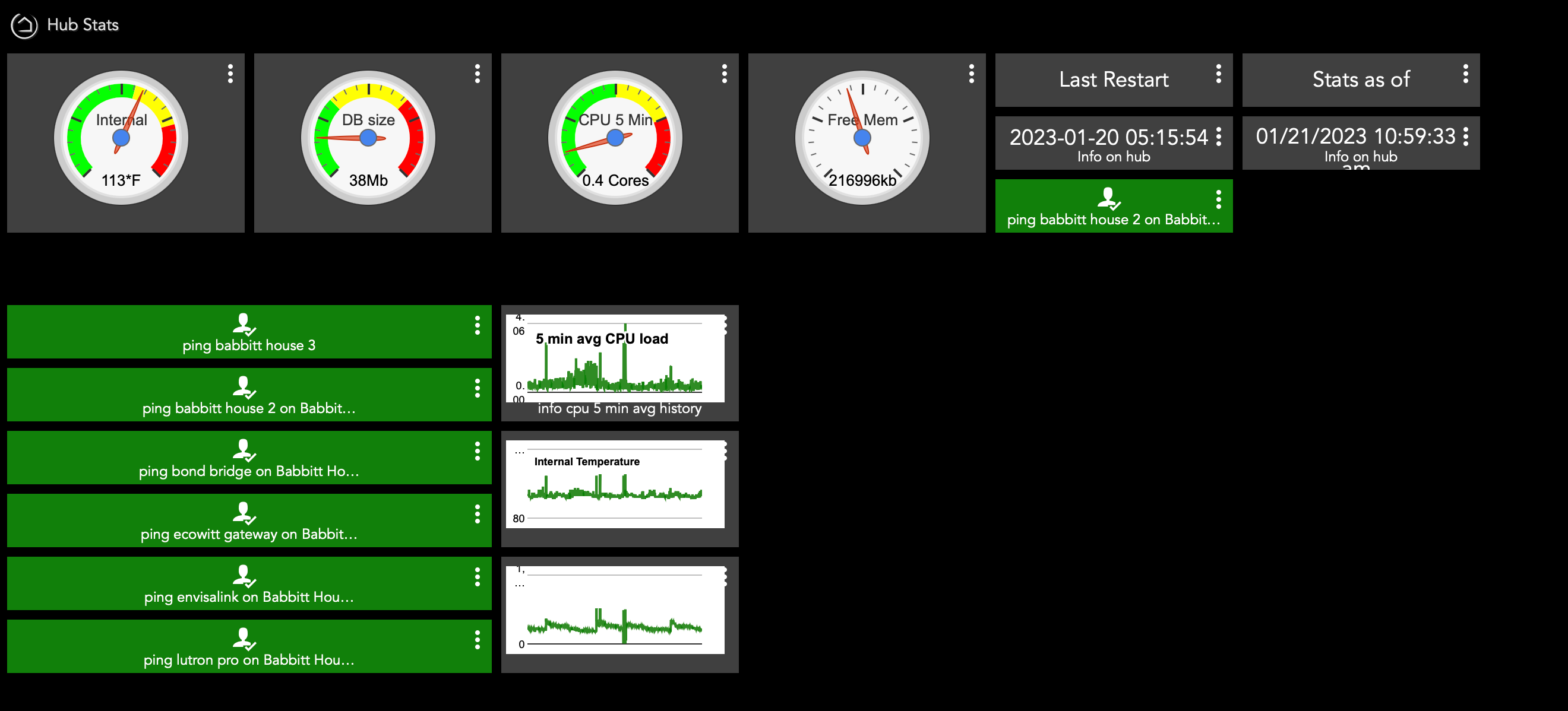

I also use @thebearmay's hub info driver and Hubigraphs to keep an eye on critical hub stats:
The biggest problem I have is free memory declines steadily over time and eventually causes me to reboot. It's definitely a memory leak somewhere but I haven't tracked that sucker down.

Nice gauges. I run hubigraphs on one of my hubs to graph inside temps and humidity plus outside illumination but the gauges are cool.
