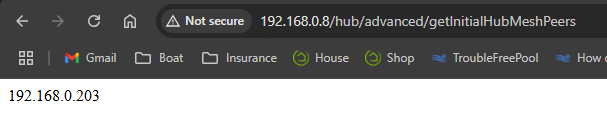

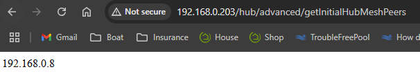

I rebooted both again and still nothing. Polled each one using getInitialHubMeshPeers and the entries are correct. Still don't see eachother though.

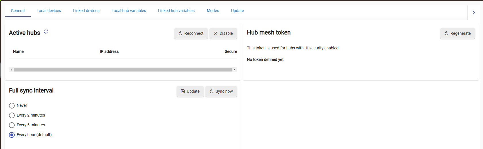

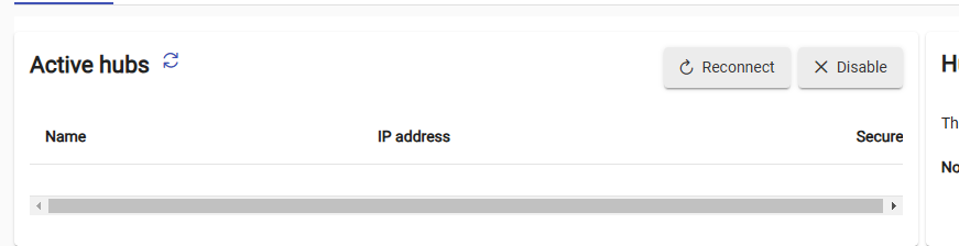

It can take several minutes after a Reconnect for you to see anything. What does the Hub Mesh screen show under Active Hubs? If there are hubs listed there you coudl try requesting an Immediate Sync (will take a few minutes to complete).

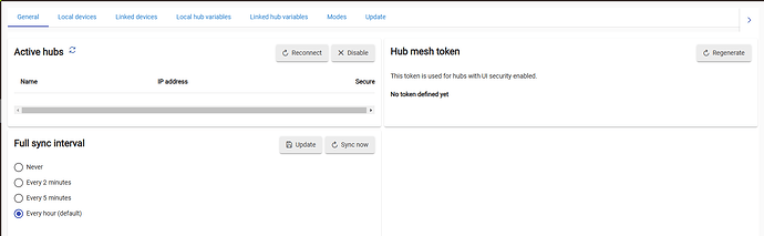

There's nothing listed at all under either one of them.
I tried changing IP addressess of both hubs, and updated the HubMeshPeers settings. Full Disable / reboot / enable / reboot cycle and still no change.

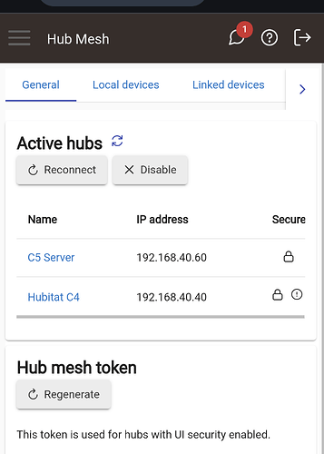

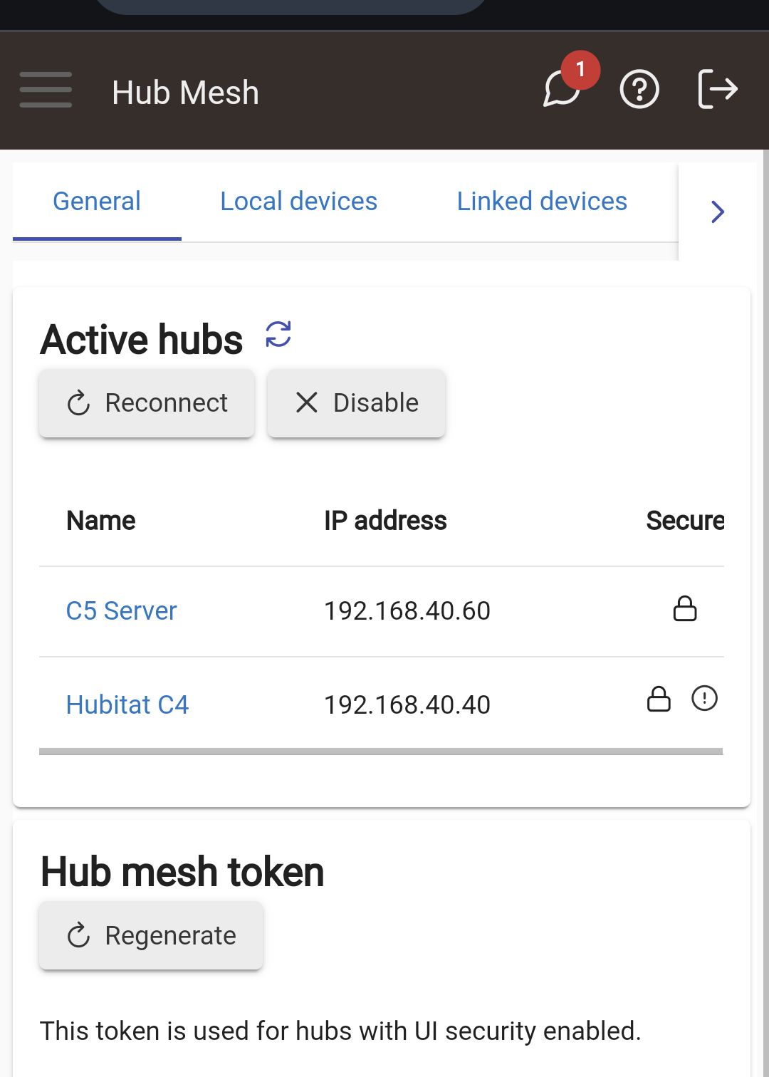

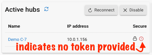

I don't think this applies since I don't have UI security enabled....also there's nowhere to input that token since the hubs don't even see eachother. From the documentation, I would need for the hubs to see eachother before I can do anything with the token:
Shouldn't need the token if not using Security, but you are showing an active hub, so HubMesh working for at least one other hub.
This screenshot is not mine - it's from the Hubitat documentation site for Hub Mesh.
