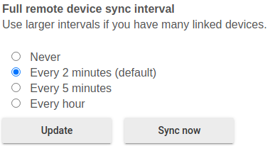

What's the full sync interval for the target hub, the one with linked devices?
It's in Settings - Hub Mesh, at the very bottom of the page.
Also, does triggering Sync Now manually have an effect?
Sync interval is set to 2 min. Manual sync does not update to the correct name.
