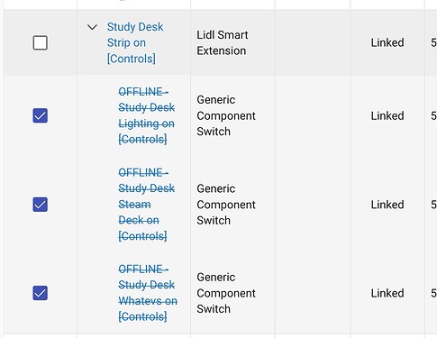

Getting some weird behaviour with Hub Mesh on 2.3.9.162 between a C8 (hosting the device) and a C7 (receiving the device via Hub Mesh). Firmware versions are matching.
I'm sharing a smart extension with three child devices, which are the three individually controllable sockets on the extension. The parent device reports in perfectly and is controllable, turning all sockets on and off at the same time. But the child devices, which are all Generic Component Switch devices, are marked as offline. They work perfectly on the host hub.

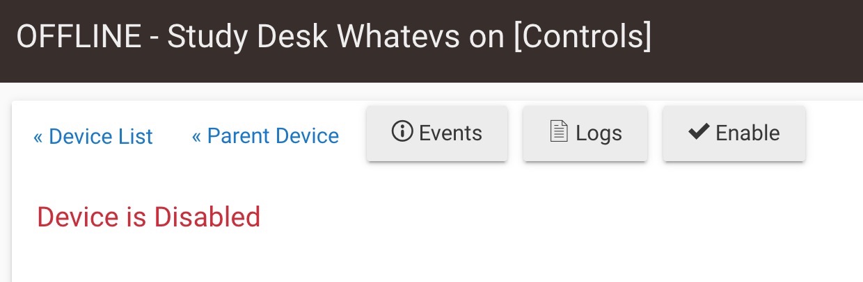

On the receiving hub I see that they're disabled. I hit the Enable button and for a matter of seconds I can control the individual socket. It almost immediately becomes disabled again. I don't see anything in the logs related to this.

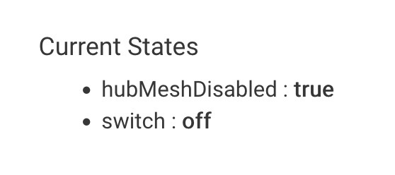

While "Current States" are shown, I see hubMeshDisabled appear in the states.
I refresh the page and it's back to being disabled.
