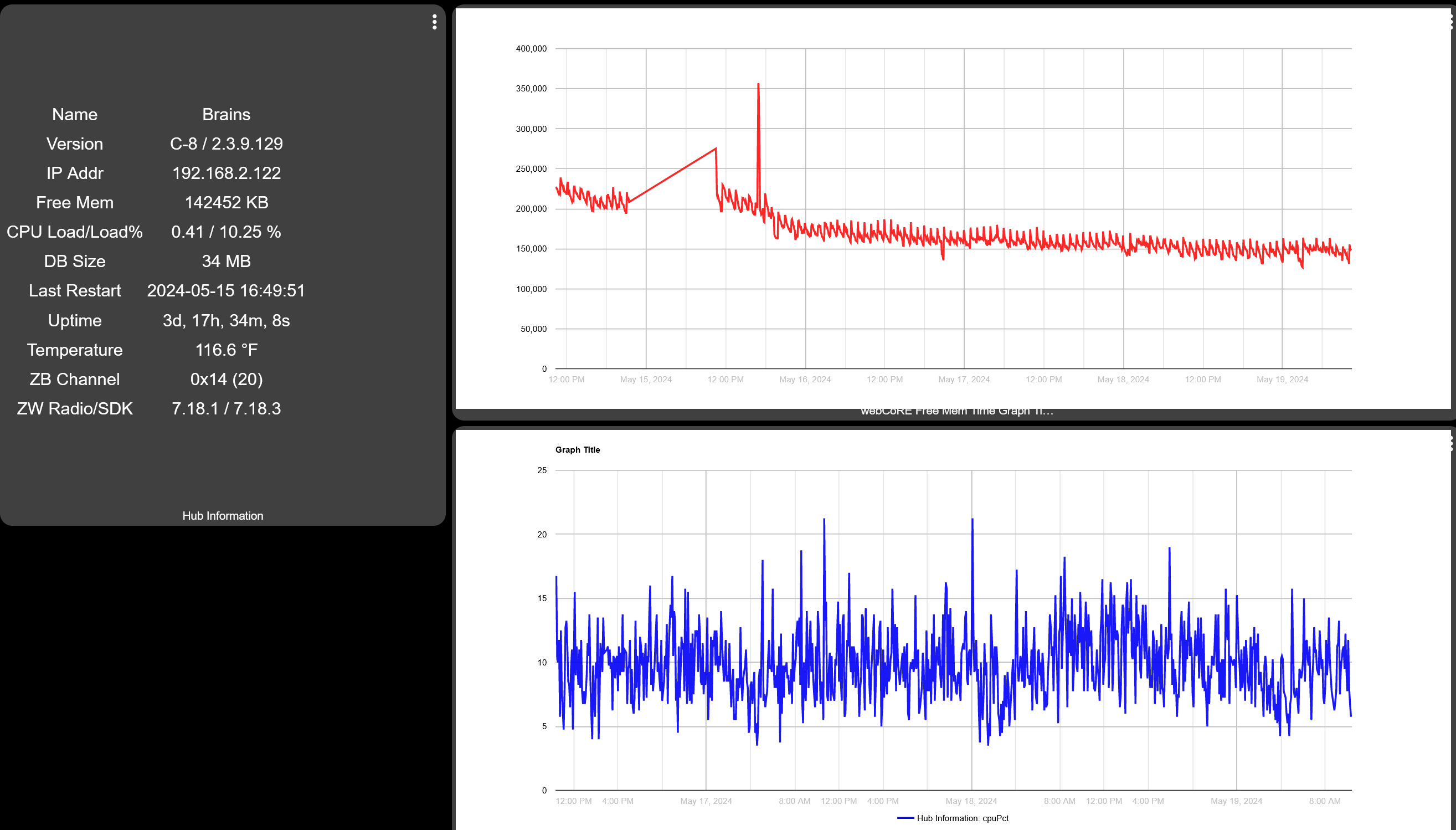

You can reboot with the zigbee radio goes off line by using a hub event trigger but that doesn't solve your issue, it just bandaids it. Start with appstats, disabling all 3rd party integrations and see how things behave. Then start rennabling things., I would also use webcore graphs and Hubitat Information Driver to monitor memory and cpu levels to see if they're dropping to dangerously low levels when the zigbee failure occours. This can be handy in diagnosing the issue. You can also tag one of the support team for assistance and they can look at your engineering logs (you do not have access to them)

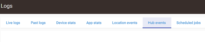

As Rick noted, look at Logs>Hub Events - do you see any Zigbee Radio entries there?

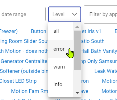

On your Past Logs tab, use the Level option to filter for Errors and Warnings to see if any devices/integrations are running amuck:
The log-hub events just shows the two instances of "Zigbee radio is offline" each followed by my reboot

Dam Rick, you run your hub at 150K ? Mine slows to a crawl at anything under 250K and the page load time is unbearable.
When a C7 was my main hub I also used to be fine down towards 150 - 160mb - I wouldn't know it was that low unless I looked. W/C8-Pro now as my main hub memory is never an issue, and my now lightly loaded C7 never goes below 400. Lots of YMMV going on w/this stuff...we all have different devices, device types, integrations, environments, etc.
In my working life when I worked w/teams trying to address/minimize customer Wi-Fi issues I thought that was a PITA - this stuff can be five levels messier to troubleshoot.
Mine has always been between 140 and 180. I've never noticed any slow downs what so ever. I've had my hub down to 87 before I noticed delays (this was way back when when memory leaks were serious). I have close to 200 devices and maybe 30 or so apps. So far no real issues. Even during the beta.

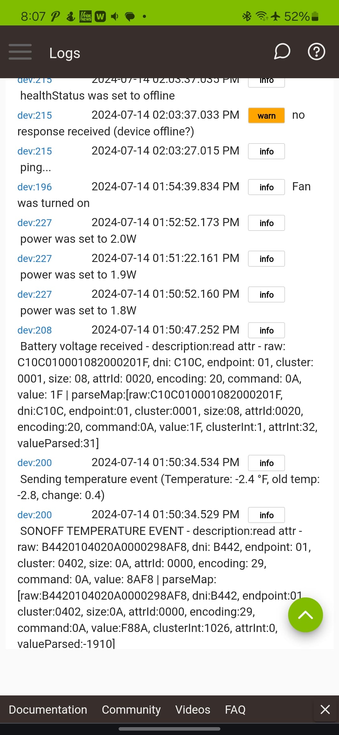

I took a screenshot of the log just before the first device reported a problem...
Any ideas?
