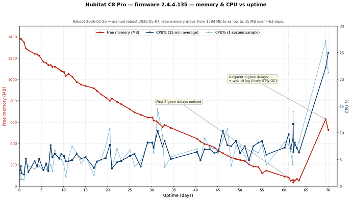

A follow-up on this. I updated to 2.4.4.135 (released 2026-02-25) and rebooted on 2026-02-26 10:14. The release notes for that build mention "likely fixed a steady memory leak on C8 Pro hubs", so I started a fresh long-uptime run with frequent samples to see if the trend was gone.
Result, after ~70 days of uptime: the leak is still there β€” same shape, similar slope. Manually rebooted today (2026-05-07 11:20) because the symptoms were getting in the way of automations.
What the chart shows
  • Free memory falls almost linearly from 1384 MB at boot down to 35 MB at ~62 days uptime. That's roughly βˆ’21 MB/day of free RAM, sustained, with no plateau.
  • CPU stays relatively flat (3–10% on the 15-min average) for the first ~60 days, then starts climbing as free memory gets squeezed. Clearly the memory parameters of the JVM were changed in this version.
  • At ~61 days I started noticing the first delays in Zigbee command execution. Same hub, same automations, same routines that were instant at day 5 β€” now several hundred ms to a couple of seconds.
  • At ~69 days delays became frequent and longer (single Zigbee instructions occasionally taking ~7 s, web UI taking several seconds to load a device page on the first interaction). At that point CPU jumped from its ~6% baseline to 22–27% and free memory bounced back from ~50 MB to ~628 MB β€” which to me looks like a classic stop-the-world full GC finally running because the heap was exhausted, and continuing to run frequently from that point on (which would explain the persistently high CPU and the visible UI/Zigbee stalls).

The underlying memory behavior on the C8 Pro is still leaking at roughly the same rate I was seeing on 2.4.3.172. The hub eventually self-recovers via aggressive GC, at the cost of sustained high CPU and user-visible Zigbee/UI lag, until something forces a reboot.
I have the raw 70-day dataset (uptime / cpu15Pct / cpuPct / freeMem) if it would help the platform team β€” happy to share it.
