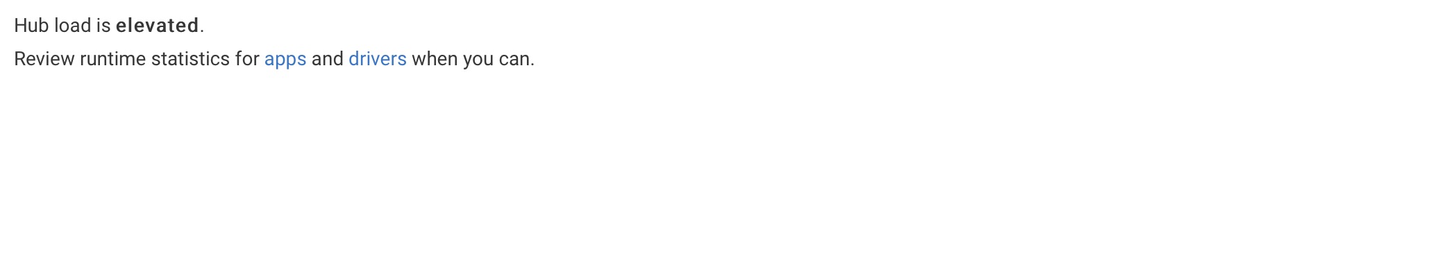

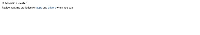

Hey,
I got this warning. It's a pretty new hub, grand total of 8 apps, 8 rule machine rules, and 66 devices. Should I be concerned? I have had the webpage open basically all day fiddling and setting stuff up, but I did not expect to overload the hub already. Especially since I do plan on adding like.... 12 room lighting automations and 15+ other automations
It's gone away now, but I went through the logs and statistics, and I can't find anything crazy. Looks like Advanced Hue Bridge Integration is perhaps using more than necessary, not sure, but even then, it isn't something I would expect to cause concern

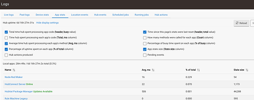

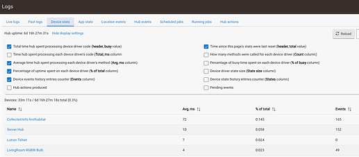

For comparison, here are mine for one of my hubs:
Note especially the middle statistics column: % of Total. The LARGEST is less than 1% over six and a half days.
Apps are even lower at two tenths for the worst case. :slight_smile:
I point them out because those are the first numbers I'd look at if I got that message (and I have, but not recently.)
