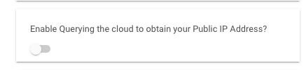

Why not just turn off the option?
Screen Shot 2022-11-19 at 11.59.20 AM

DUH, I don't recall ever turning it on. In any event I have Fios Gigabit Fiber and the IP is very stable, sometimes lasting 6-8 months and PFSense has no trouble picking it up. Which cloud site are you referring to?
Thanks I'll just turn off the option
