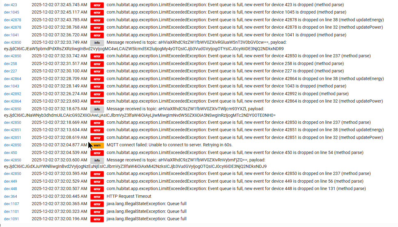

Hub has lots of errors ...I didnt really change anything
C7 V 2.4.3.158
My hub has gone very unresponsive...I cannot see device pages
I looked at the logs and I'm seeing tons of errors... my apps didn't change so I do think something is going on with the hub...sadly my last backup is a year ago....
I have rebooted the device and even stopped my mqtt broker. Here are the errors ...is there anything i can do short of load an old backup
Might want to try a reboot with the database rebuild option.
thx it now says my zigbee network is down
That might be progress... easiest way to address that is usually a shutdown of the hub followed by a removal from power for about 30-45 seconds. When you plug it back in it should do a power up with the radios cache reset and functional.
Did you also have a low memory warning for the hub?
Just yesterday, after spending time testing and debugging some custom apps, this happened to me as well. I am sure some of the errors in the code I was testing lead to it, but it happened at the same time as the low memory warning.
For me, a reboot was all that was needed.
