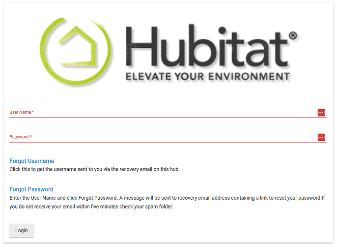

I browse to http://192.168.0.25/hub/allowSubnets

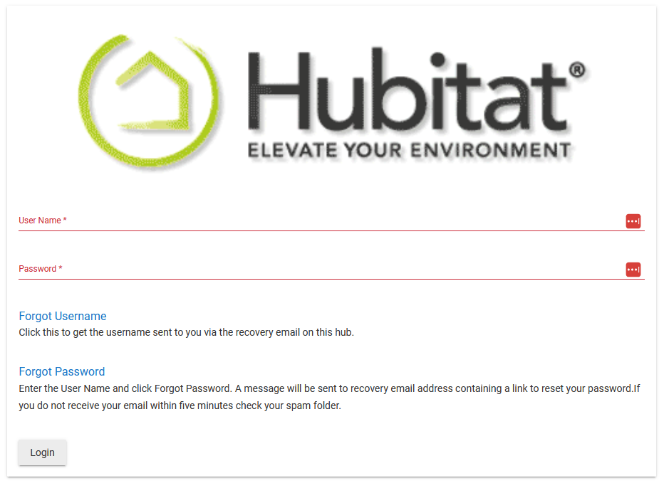

and I am redirected to http://192.168.0.25/login?loginRedirect=%2Fhub%2FallowSubnets
And when I enter my uname and pw, I'm redirected back to the same page.
There's nothing in the logs to indicate the endpoint was queried or that authentication failed. How do I enable this logging?
