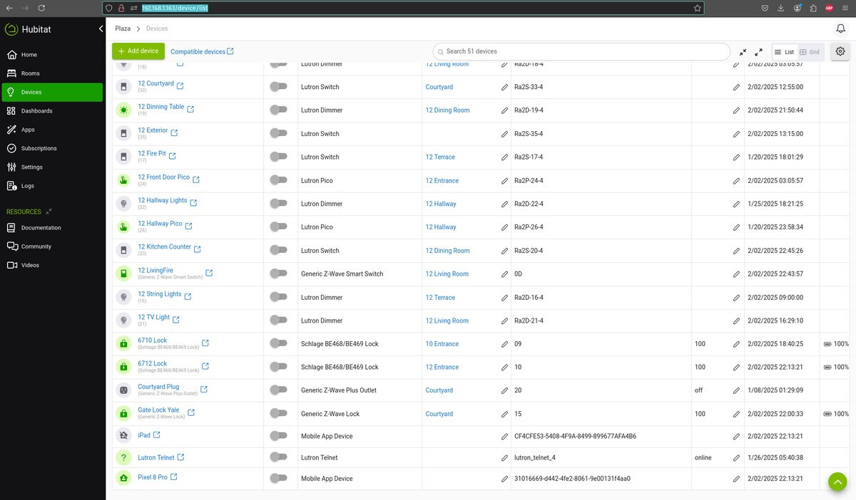

One of my Airbnb guests which happens to be an IT specialist wrote me the attached note.
“I found every connected devices, and noticed that the 2 flats are mirrored (there are the same devices in both appartment). And i Know that because the biggest flaw i found is that the admin interface for the hubitat does not require any logging. Someone with bad intentions can see the doors password, activate/desactivate every devices... I found other smaller flaws as well. Give me a bit of time to redact a small report and i'll send it to you ! With small recommendations as well.

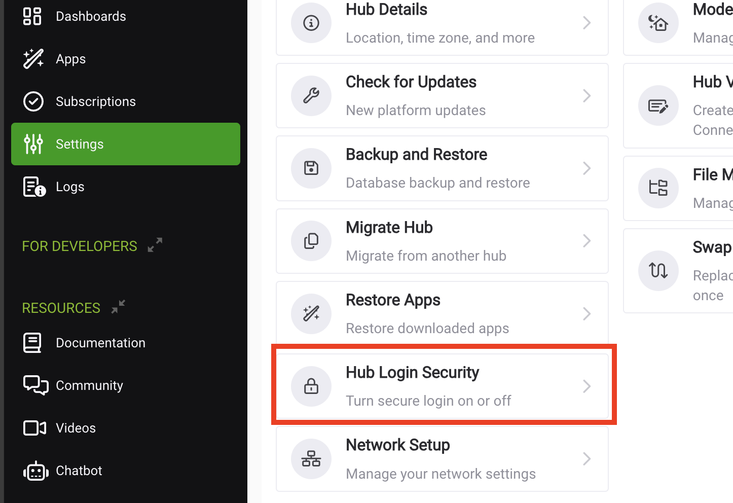

How do I implement security on the admin login.
This perhaps?

I second the suggestions above to look at Hub Login Security, a feature I would have strongly recommended to be enabled on a network accessible to others. Note that this will not prevent access to the Diagnostic Tool, which a malicious user could probably easily figure out how to get into and use to soft reset your hub or reset the radios. If you have cloud backups, these are recoverable (and having it registered would prevent a true full reset, not that there would be much difference beyond the registration afterwards).
