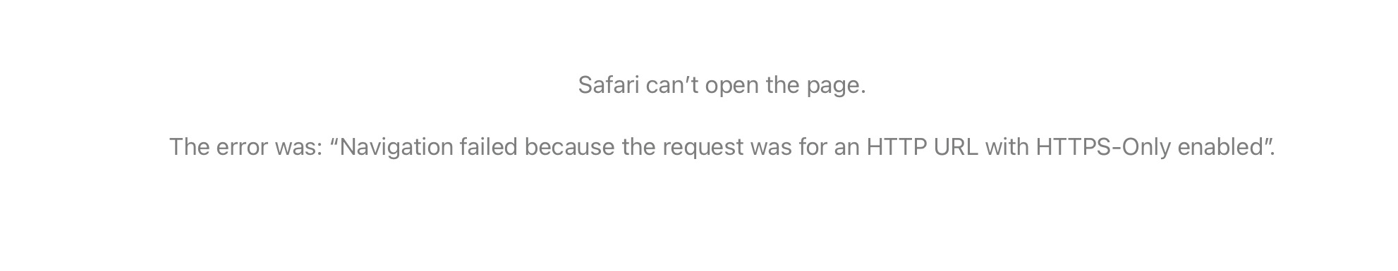

When I use my PC browser to connect to the Hubitat C7, all good. When I use the Hubitat app on my iPad Air, I get this for "add device" + link. A hassle to run all over the house to add a device.
Is this a hub setting or an iPad safari setting to allow.
Never mind - was a default Safari app setting in iPad.
Per google:
To fix the Hubitat navigation error on iOS 26+ caused by HTTPS-Only mode, you must disable the "Warning Before Unsecured Connection" setting in Safari. Go to Settings > Apps > Safari > Privacy & Security and disable "Not Secure" Connection Warning . This setting often acts as a block on local IP addresses, causing the error in the Hubitat

Failed out both ways. After allowing “not secure” in safari app settings, both the app and browser are fully functional. New “feature” in iOS 26.

iPad - setting>apps>safari
