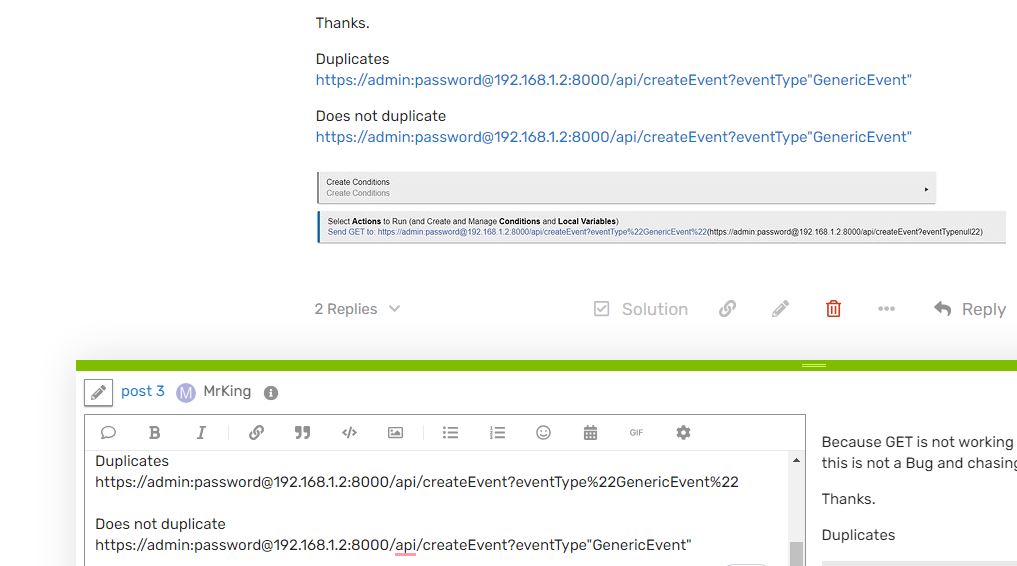

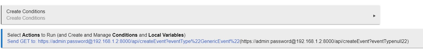

I cannot get HTTP GET command to work, but it works in any browser. After reading through the forums, they said it might be the quotes causing the problem and to use a confirmed URL. So, that is what I did, and now Hubitat shows the URL with parentheses around it again. Not sure why GET does not work and why there are parentheses around the URL when I change the quotes to %20
Because GET is not working either way and there is an unexplained difference I wanted to confirm this is not a Bug and chasing a wild goose.
Thanks.
Duplicates
https://admin:password@192.168.1.2:8000/api/createEvent?eventType"GenericEvent"
Does not duplicate

LOL, crazy. I thought I made a mistake in my original post. So I went to correct it and even the community board corrected the %20 to quotes. Too funny. See picture.

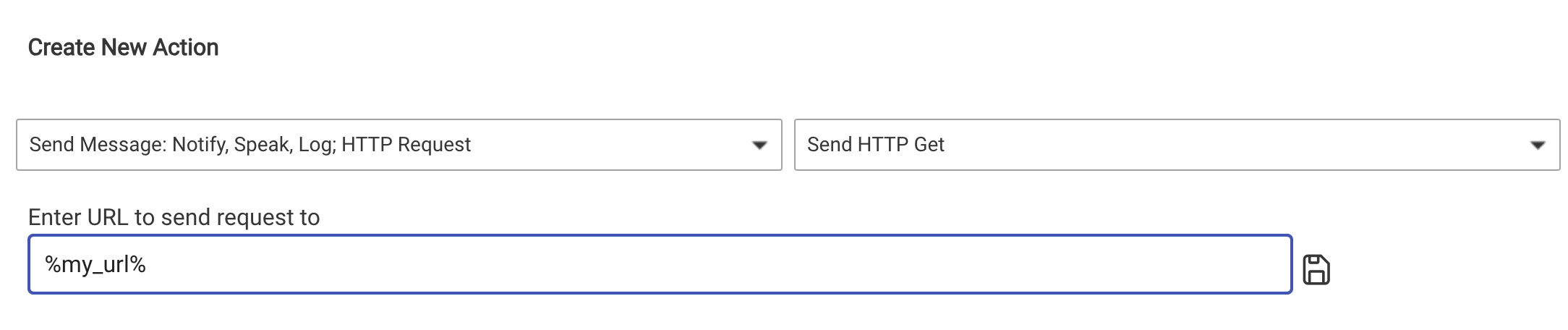

Anyway. How can I fix this and why the parentheses? Maybe use a variable for the entire URL? I will try that but what is normal practice?
The easiest way is to use variable.

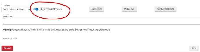

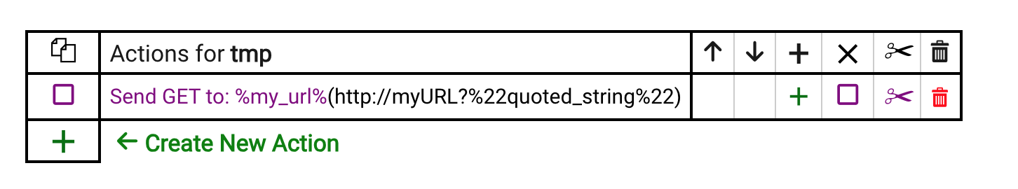

Since your string has variable replacement, the string in parentheses is showing what the actual request will be with variables expanded.
Got it on the parentheses, thanks. For others, see the picture for an explanation.

For your case, I think what you want to do is to set the variable with the encoded string and then use that for the GET location. If you are manually entering the variable, use %22 instead of quotes.
