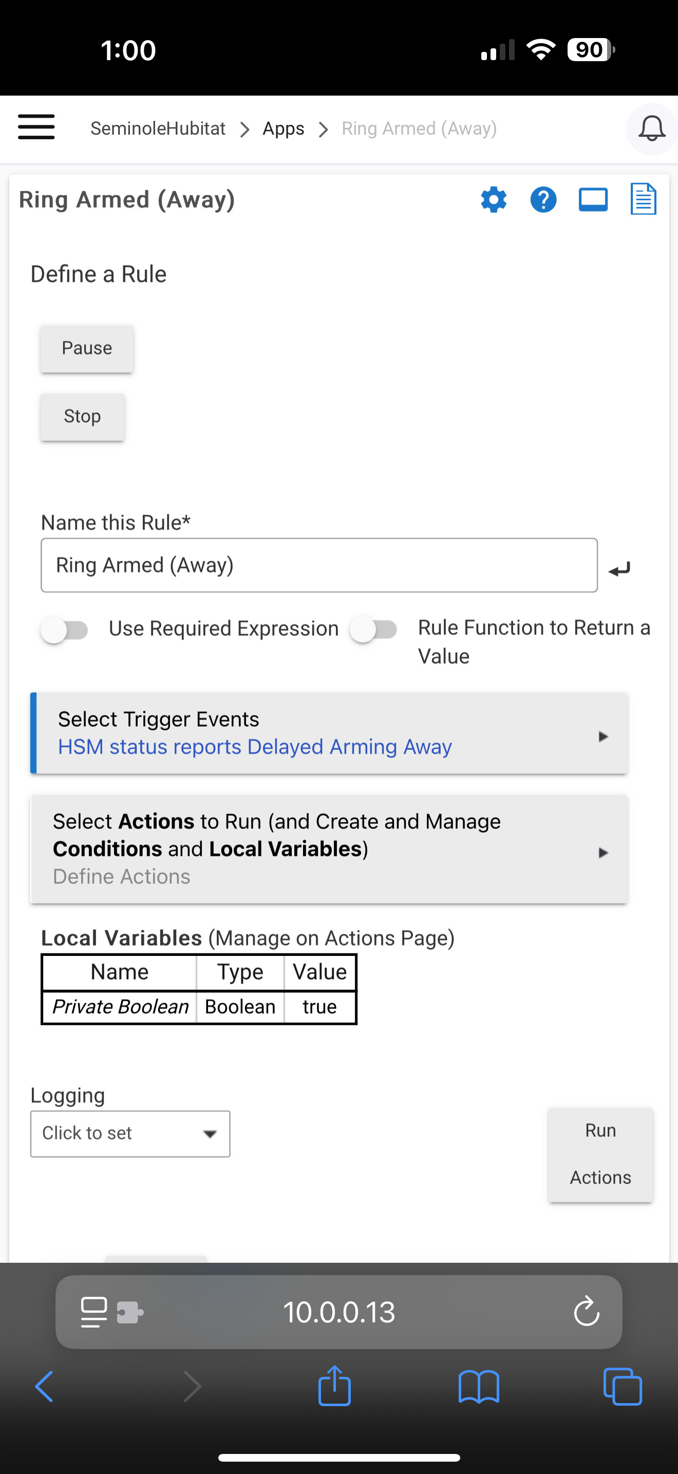

So far, I was able to get Ring synchronized to Hubitat and it works pretty well. My only issue is that when I use HSM to arm Away and I setup a Delay, it takes 60 seconds before it sends the command to Ring which then has another 60 second delay built in.
However, if I arm Ring Away it starts the HSM Countdown right away. So I'm clearly missing a step in the HSM to Ring Rule that will trigger the Ring countdown at the same time as the HSM countdown is triggered.
Here is my current rule. I tried setting the HSM Away delay to 0 but adding a delay in the rule, however the countdown in the dashboard does not work with this methodology and it simply arms it instantly.
Thoughts?
For anyone running into the same issue, the Trigger Events is HSM Status reports Delayed Arming Away rather than Armed Away.

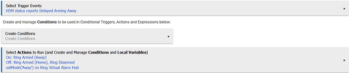

Hello, I’m fairly new to Hubitat. I’m trying to mirror your Rule for Hubitat to switch my Ring Alarm modes too. I’ve got the virtual stuff set up but I’m at a loss how to input the Actions you have listed. I’ve invested a lot of hours to no avail. Can you please advise me how this is done? Thanks in advance!
Hey Rick,
Do you mind sharing a screenshot of how your rule is setup and expanding a bit on what you're trying to achieve?
I ended up removing the Ring integration and going with an Echo Hub from Amazon but I did get to a point where I had both systems synchronized. It should be fairly simple if you have HSM installed.
Hi, Honestly, I didn’t get far. I couldn’t figure out how you entered the 3 commands in the Action section. My end game is to add this function to my Home Secure routine to sync my new Ring Alarm in Away mode. I’ve taken my screenshots per your request. Thanks for your assistance!
Hey Rick,
It took me a moment to remember how I had set this up.
So the first thing you want to do is go to your Ring Alarm Hub under Devices, then Preferences and ensure you enable the synch with HSM.
Next, you will want to go to Rule Machine and do the following:
  1. Select Trigger Event
  2. Add New Trigger Event by clicking on the (+)
  3. Select HSM Status from the Picklist
  4. Select the status you're looking to create the rule for, if its for Arm Away make sure you select Delayed Arming Away
  5. Click Done with Trigger Action
  6. Now you should be back in the main page for the rule setup, where you can create Triggers and Actions
  7. Click Select Actions to Run
  8. Click Add New Action by clicking on the (+) sign
  9. Pick Run Custom Action from the Pick List
  1. Then select Actuator under Capability of Action Device
  1. Then select your Alarm Hub under Actuators to act on
  1. Under select custom command, use setMode
  2. Then click Add a Parameter
  3. Write "Away" as the parameter in the text box
  1. Then click Done editing action
Once you're done, install the rule and you can test it. You'll have to create one rule per mode.
