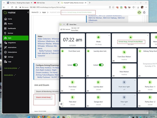

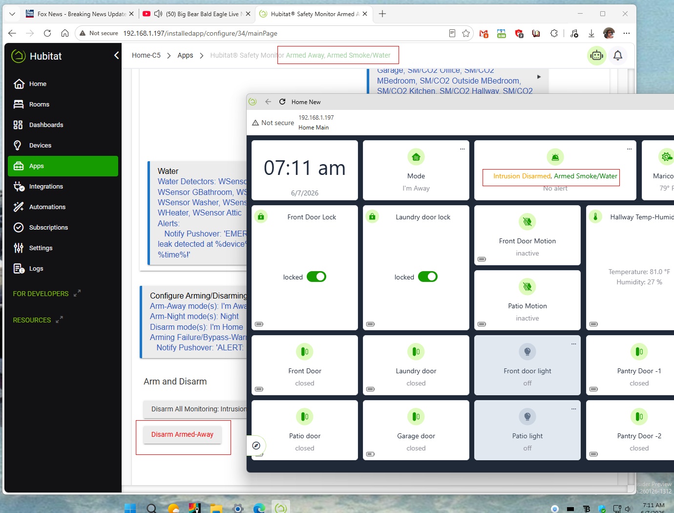

I’ll use I’m Away mode, but this also happens with Night mode and other modes as well I suspect. Once I updated to 2.5.0.153 this morning when setting the mode to away, the webpage when logged into the Hub shows the correct information, but dashboard update does not change from I’m home. It stays stuck there no matter what mode I set, however the mode even though it says I’m home is really set for Away or Night or another mode if I select that.
This image below shows 2.5.0.153 shows webpage logged into the hub showing correct status of I’m Home and has a dashboard pulled up to show status as well. Second image shows I’m away and the dashboard still shows I’m Home but webpage of the hub shows that I’m Away correctly

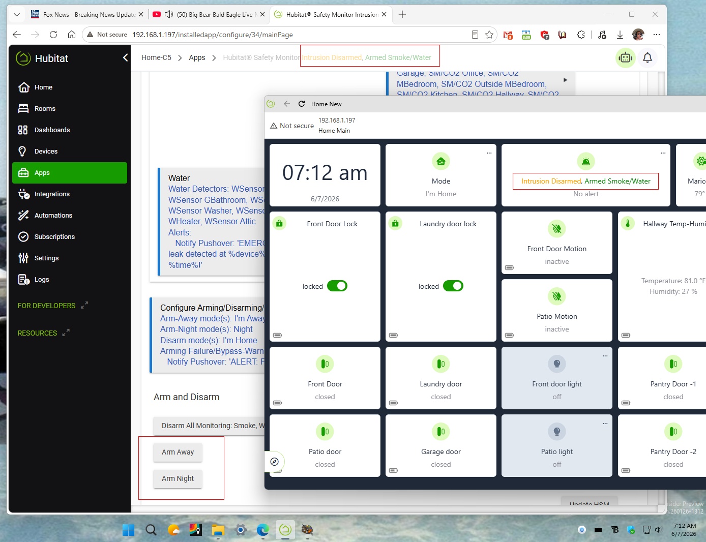

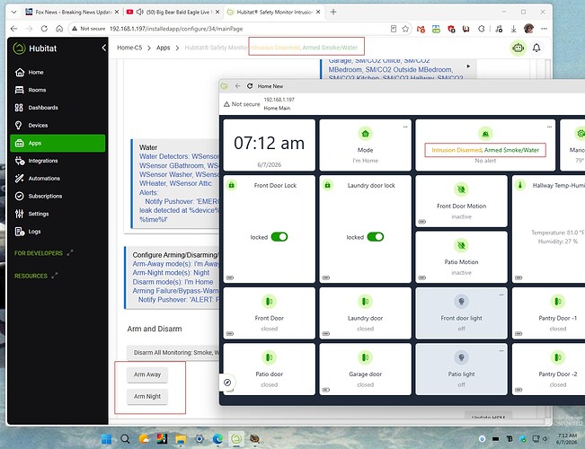

This image is from 2.5.0.135 which I’m running again correctly showing status everywhere in the same images and testing as above with the latest version
