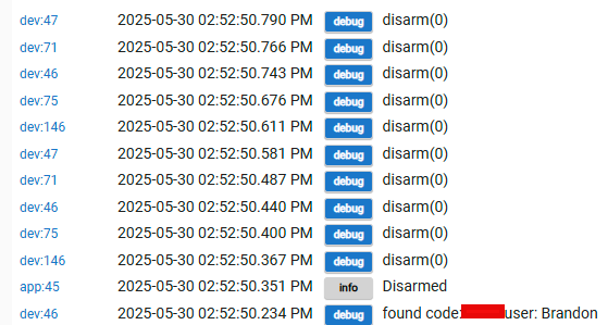

@bravenel @bcopeland When Arming/Disarming HSM my Keypads get the Arm/Disarm message 2x. I have 5 Keypads and the keypads sometimes will go red and stop communicating which leads me to believe the extra traffic may overwhelm the zwave network temporarily.

dev:46, 146, 75, 46, 71 - Ring Gen 1 Keypads (Also this issue pre-dates the recent Ring Gen 1 Keypad update, just reporting now as I enabled debug logging and can see the extra commands being sent)
@bcopeland - Would you consider adding a debounce delay to the Ring Gen 1 Keypad driver. HSM seems to be sending arm/disarm commands back to back (aprox 300 milliseconds apart. Logs in first post.)
I'll check into this.. But I don't think debounce on commands would be appropriate.. But there could be a different solution.
This is a bug in HSM. Found and fixed, heading to a release...
