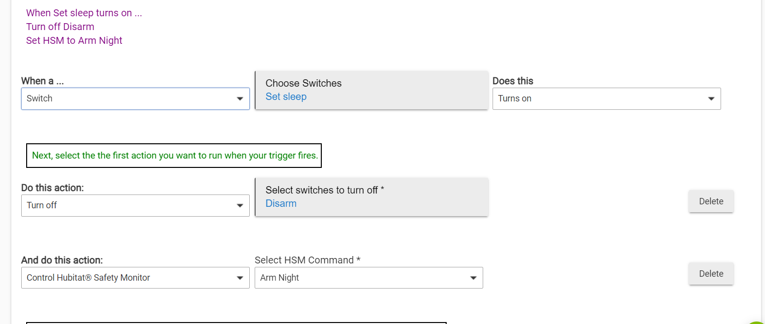

Here's how I arm the system (arm switch):

The "Use every open/close and shock sensor..." option in HSM can only reference actual contact and shock sensor devices that are paired directly to HE, not virtual switches that are used to mirror in such devices from somewhere else.
