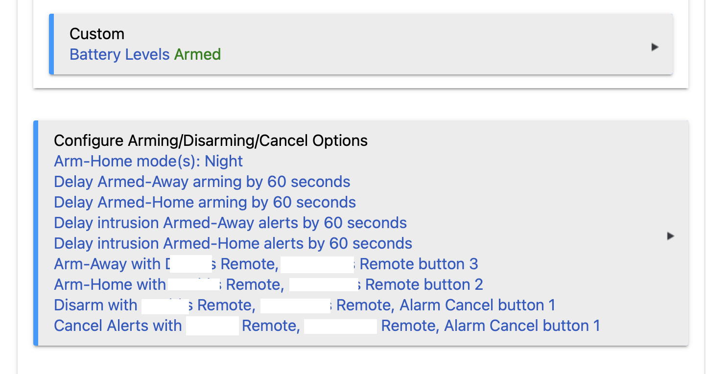

HSM config screenshots:
Every HSM action is logged, and events are tracked in the System Events that you can view from the top level menu. So that's the place to start. I really need to see a screenshot of the logs where the event is thrown, showing the entire line (not copy/paste). Unfortunately, the error you showed makes absolutely no sense.

Your screenshot of HSM page didn't show everything. Does it show that it's armed or disarmed? Refresh the page first. At the top of the page, in the black top border, does it say armed?
Yes - see updated screenshot above
Not seeing it. Just answer the question please.
Sorry, which question is that?
Does HSM setup page show that it is disarmed or armed? Are you able to arm/disarm from that page without an error?
I understand - currently it is disarmed (see screenshot), but we are discussing an issue in the past, so I was confused.
