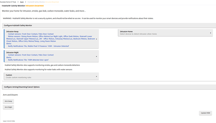

After I programmatically tell HSM to disarm, the logs say it did. but the app gui Label says it is still in its last state (armedNight). I don't think HSM GUI Label on the app is reflecting truth at all times - in fact it disagrees with itself when compared to what is in the log under certain conditions.

I expect to be directed away from HSM being the cause - but no failure on my part is visible. How do I turn Logging Up (trace/debug etc) on HSM?
The exact issue - he HSM Gui Label on my hub did not update and still shows previous state on the GUI app screen as. I do not cache my browser, and this was a fresh window open in Firefox. If I enter and exit the HSM app, (without touching anything) it clears.
I first noticed this today during basic log review as I improve my Mode Manager app. I have zero rules that touch HSM and my HSM has no external triggers except for my app. I manage it directly and only from my Mode Manager app.
"these logs also include the safety monitor. It is currently showing 'armed night' in my GUI. I'm up, home and awake. its currently Morning period. what failed?

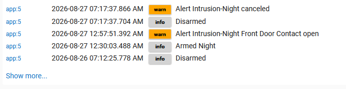

My bug hunt - evaluation of logs produced this:
I found the important part, and the Mode Manager itself did not fail to disarm HSM during the Morning transition.
In fact, the logs show the opposite.
What happened
At 07:17:37, your voice wake transaction explicitly calculated that HSM should be disarmed:
Mode: Early Morning
Control Source: Voice
Awake: true
Target:
disarmed
It then dispatched the disarm command because HSM was armedNight.
Hubitat then reported the HSM status as disarmed 572 ms later, and the app cleared its pending HSM target. The verification check also passed.
Then at 07:30, the Morning scheduled transition ran. It calculated:
Mode: Morning
Period: morning
IsSleeping: false
Expected HSM: disarmed
And it found HSM was already disarmed, so correctly did not send another disarm command.
The Morning tile update also explicitly recorded:
HSM:
Disarmed
So why is HSM currently Armed Night?
That means something happened after the logged Morning transaction or the HSM label has failed to reset.
The Mode Manager's last demonstrated HSM action was correct:
07:17:37 Mode Manager disarms HSM
07:17:37 HSM confirms disarmed
07:17:43 Verification passes
07:30:01 Morning evaluates HSM
Current: disarmed
Expected: disarmed
No action required
My conclusion
The current Armed Night state was not caused by the failure of the Morning schedule to disarm HSM. The app successfully disarmed it before Morning even started, and Morning confirmed it remained disarmed.
Therefore, one of these occurred afterward:
Another app or automation armed HSM.
A manual/dashboard action armed HSM.
An HSM-related automation or rule reacted to another device/state change.
Less likely: Hubitat's HSM state changed without the relevant event appearing in the portion of logs supplied.
The key next thing to find is an event like:
HSM Event Received -> Value: 'armedNight'
after 07:30 AM.
That event would tell us exactly when HSM changed back.
One thing I would specifically investigate
Your Mode Manager is subscribed to HSM status and logs HSM changes, as demonstrated by the successful armedNight and disarmed events earlier. So if HSM is now Armed Night and the Mode Manager remained running/subscribed, I would expect a corresponding HSM status event.
That makes me suspicious that the later change may have occurred outside this particular log window, or that there was some app reload/update/subscription interruption afterward.
But based on the logs we have:
Mode
Manager did its job correctly. It armed HSM at Wee Hours, disarmed it
when you woke, verified the disarm, and confirmed at Morning that HSM
was still disarmed.
So the failure is almost certainly a subsequent re-arm from somewhere else, rather than the Morning period logic itself.
