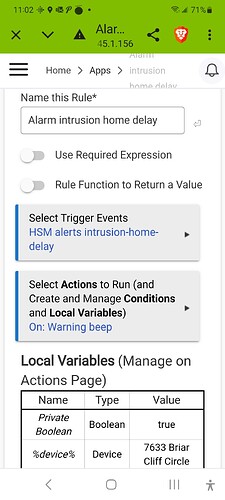

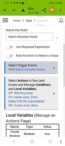

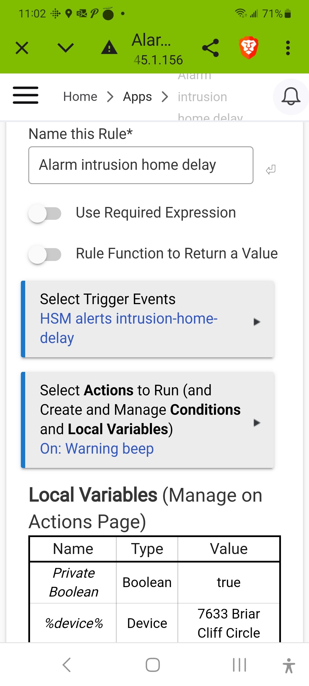

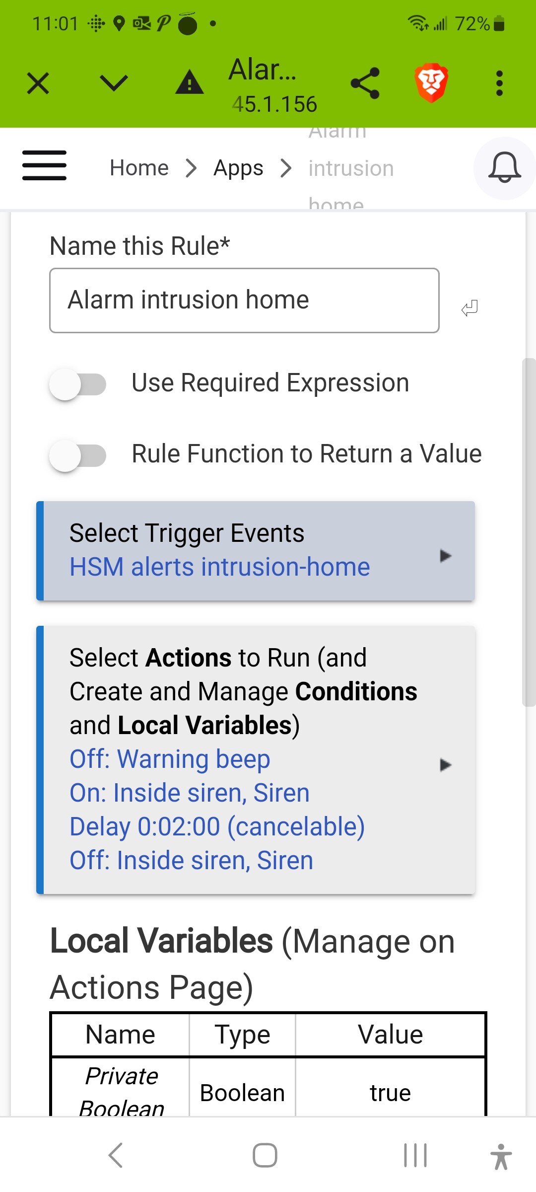

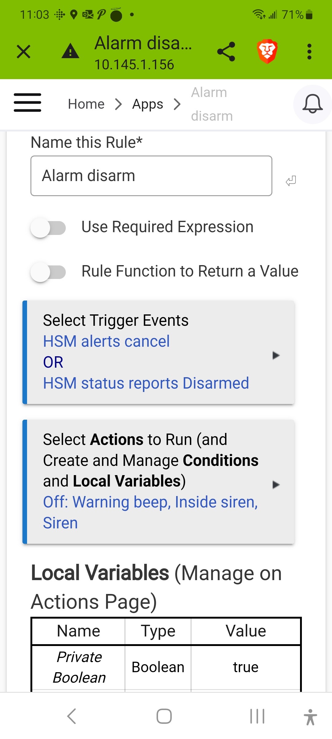

I started creating rules based on changes HSM Alerts / Status and doing away with all the reacting in native HSM. Doing it this way, you can get very granular in specific actions to take beyond the capability of HSM. Examples:
I've got similar ones. I also have a virtual button to cancel HSM alerts
