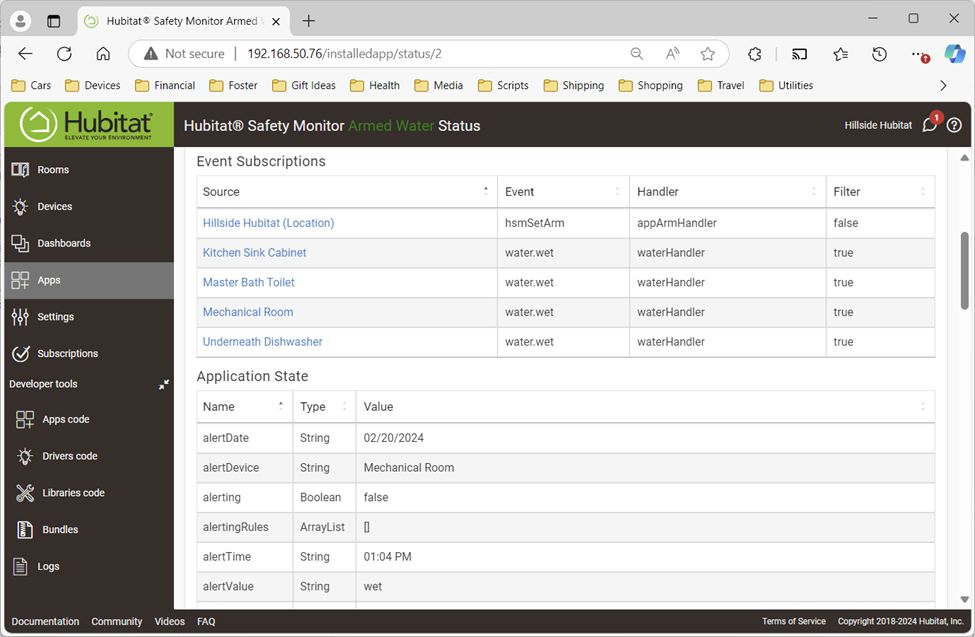

Look at the HSM App Status page Event Subscriptions. See if your water sensor is there. It should look like this (plus perhaps more):
Yup.

WIll do. While I was looking in HSM Application State I notice that the water alert was when I last tested it.
hsm3
Yeah, you've established that it didn't get the event. But I have no clue why.

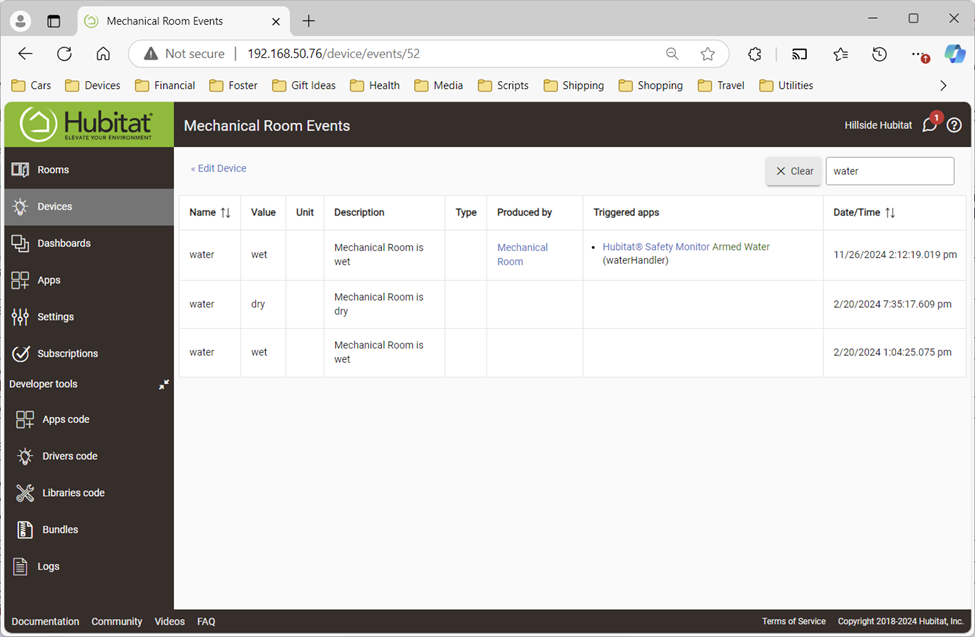

I too experienced this type of failure today. Was changing water filters and some got on one of our sensors and it began beeping. HSM is supposed to shut water valve, send notification, etc but nothing happened. The device shows "wet" on its Event history and even shows that it triggered HSM! But HSM did nothing and pretends like everything is fine. This is (in my opinion) a serious issue needing to be addressed.
