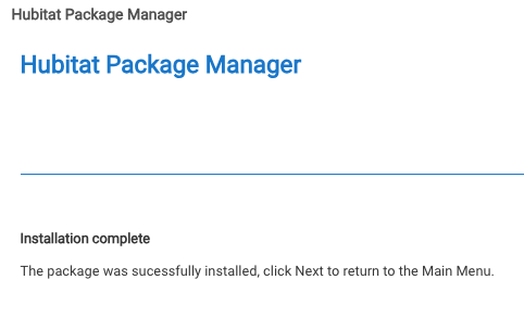

  2. The most recent user reporting this issue; said the HPM page for installing my app said the two files were copied successfully (even though they were not).

First step was to verify that using the debugging repo behaved the same, indicating it's ready to start with the debugging. It was and my first test was to alter the Package Manifest to be just the Groovy file, eliminating the file manager portion. Indeed that failed as predicted. Then to be sure, I reversed it, and made the Package Manifest only the file manager pair. Those worked as expected. (Expected, because the error message seems to be appearing at the beginning, not the end of the list of 3 files.)
I then reverted to v2.3.9 and ran the 'just groovy' install again. It failed too, so it's not a new change to the Platform causing this, unfortunately. I've put my test environment back to the latest platform and tested once more and got the same error (on just the groovy file.)
What I cannot fathom at this moment is how it's "bad" today all of a sudden. Both HPM and your Package are relatively old (in computer minutes :slight_smile: ) and the install fails independent of platform.
Not an important test, but when I was installing just the file manager pair of files, they not only installed, but repaired and uninstalled flawlessly.
