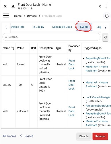

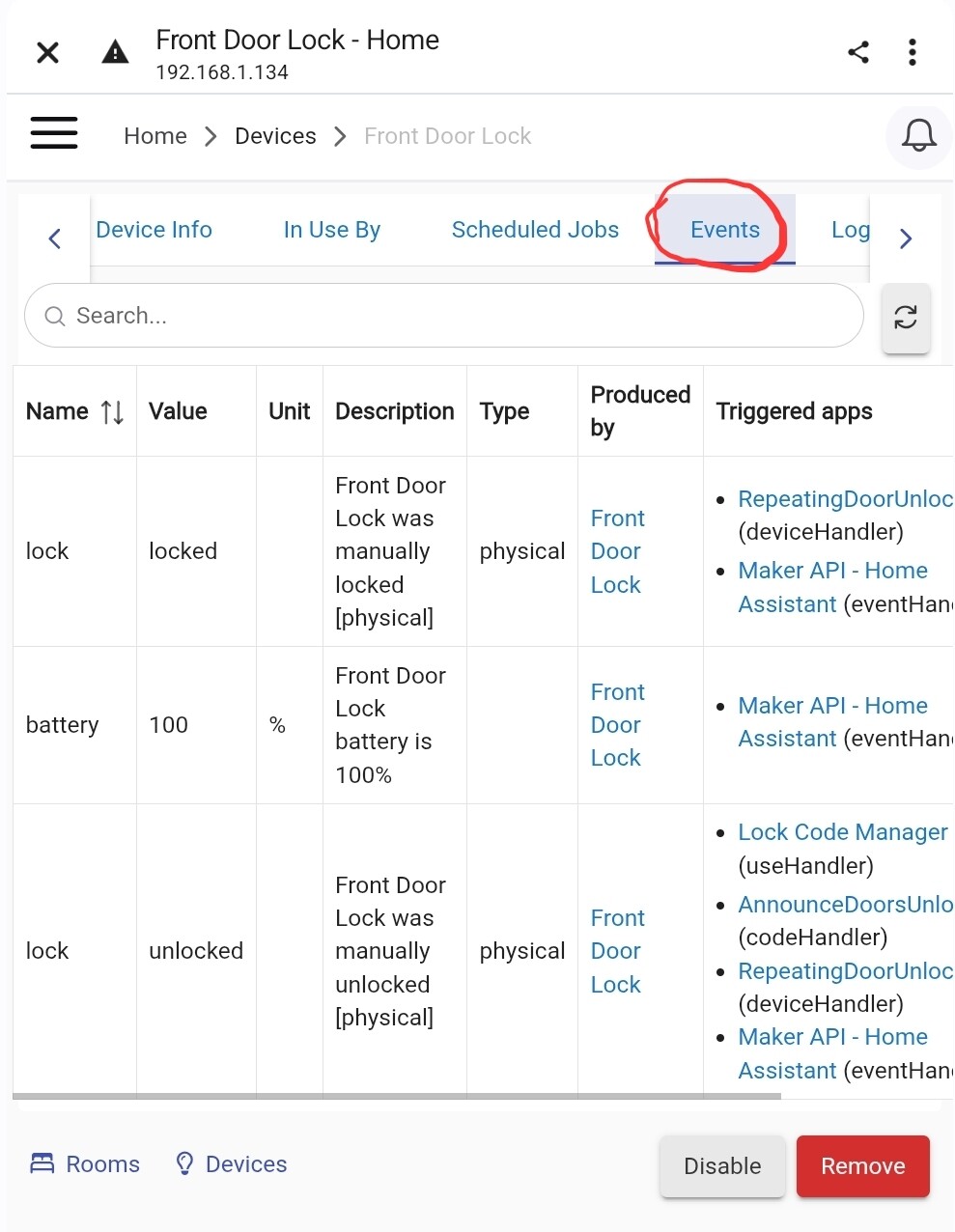

In the app, you can go to the device, and select "events" from the top tabs. The lock/unlock events should show there
Device Events
