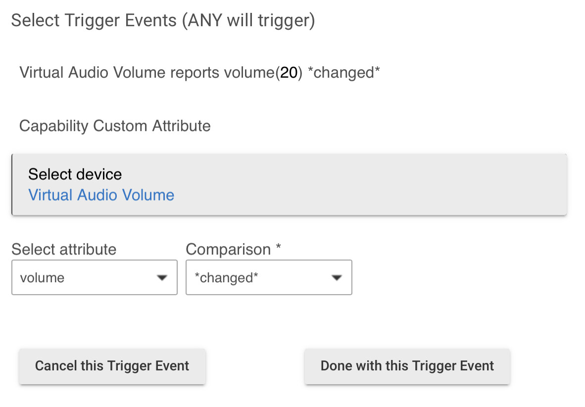

You will want the trigger to be a change in the volume of your virtual device.

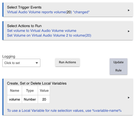

Here is a rule that will work:
In this example, it just sets the volume of another device. You can setup any action to run instead…

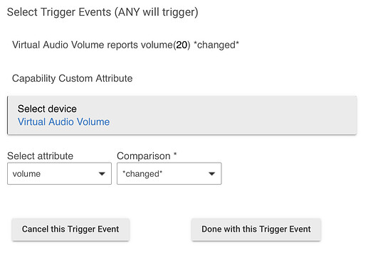

Here is how you setup the trigger from the example:
Every device’s attribute can be used as a trigger.
Thanks - I was looking for the buttons in the virtual audio volume device as triggers. It didn't occur to me to test for increase or decrease.
