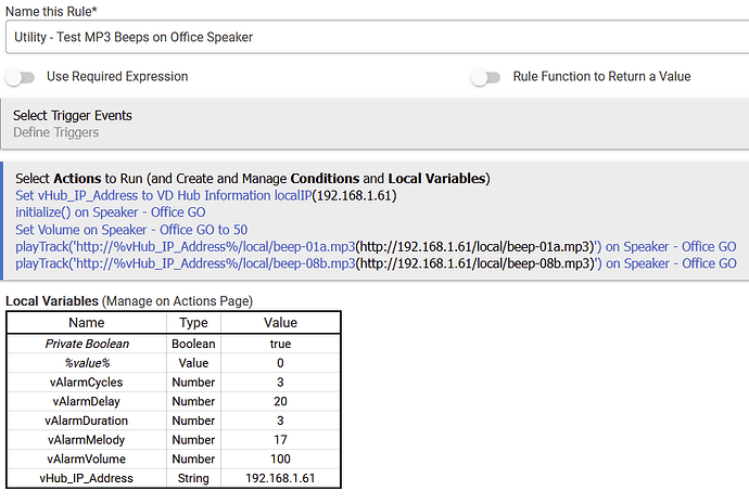

Would a variable string work? Then get the IP address at boot and shove it into that variable?
"Hub name on LAN" = "hubitat-c8p-house"
Thank you! That worked:
The virtual device, "VD Hub Information", uses the driver "Hub Information Driver v3" from @thebearmay.
