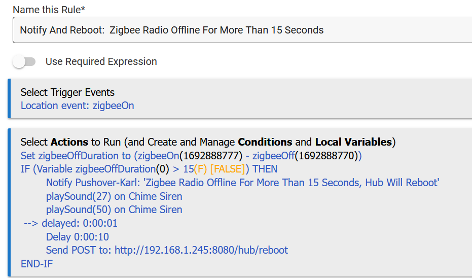

I think I'd like to test for a zigbee radio reboot, the ~10 second kind.
I was thinking, reboot if duration between zigbee radio off and on is more than 10 seconds.
Maybe have two rules: the first triggered on radio off and put the time into a hub variable
The second triggered on radio on, put that into a hub variable, compare the two values, and then act on it if the difference is more than 10 seconds, or so.
Am I on the right track, or would there be another way to accomplish this?

This is what I have.

They've generally been between 7 and 8 seconds. I feel that I shouldn't reboot the hub for those radio reboots, only for a more serious, longer term radio outage.

edit: Does my rule look good to you?

It looks fine but honestly I don't know that you need it. I haven't had to reboot my Zigbee hub because of the radio restart, only if the memory gets super low.
