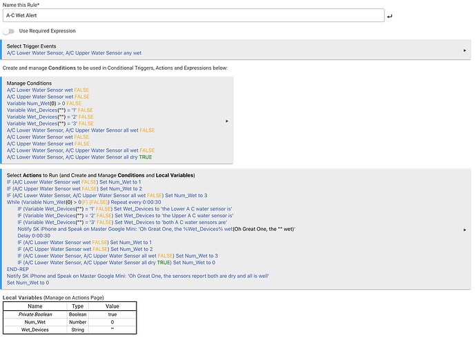

I'm starting to work on this. I want to vary it a bit from what you did. I started by saying if any of my 2 water sensors are wet. I also created a variable Num_Wet and set it as a number with a value of zero. I then want to add a couple of If statements that IF Upper Sensor is Wet THEN Num_Wet = Num_Wet + 1 and then another one to say IF Lower_Sensor is Wet THEN Num_Wet = Num_Wet + 1.
I went into RM and created a new rule. I set the triggers to any of my 2 water sensors being wet. I then created an Action to run as a Conditional Action of IF Then and the Expression is A/C Lower Water Sensor is Wet but I can figure out how to put in the part to have Num_Wet = Num_Wet + 1.
Here is a screen shot of where I'm getting stuck:
I tried clicking on Edit IF Exhpression THEN but it takes me to here:
If I chose Insert before Expression Element and then pick the A/C Lower Water Sensor wet it wants to be set up what is going before that (as it said). I don't want to have something before that. What I want to do is to set the IF part.
Help please.

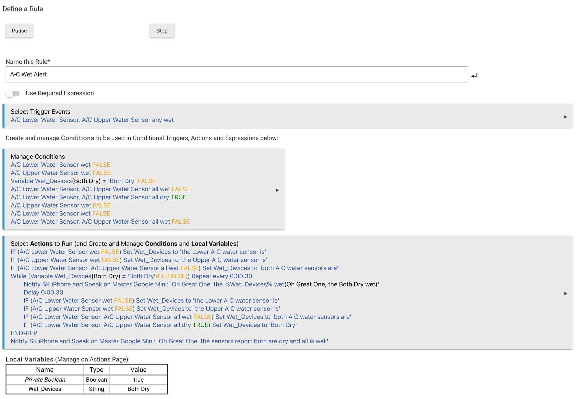

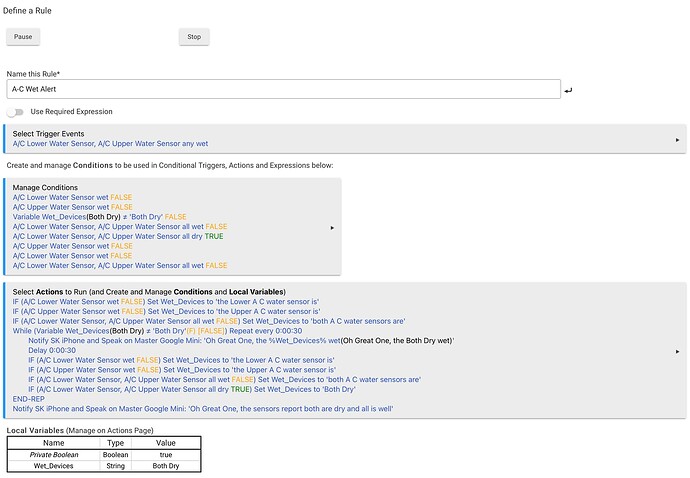

I finally ended up using setting a series of simple conditions and ended up with this:
This certainly isn't the most elegant rule, and I don't know if I need the "Repeat every 30 seconds" in the While statement, since I put a 30 second delay in after the Notification, but does it look like it will work?

The whole reason I'm creating this is that I don't want to have to hit the cancel button. I did set it up in HSM and when they are both dry I get this clicking sound every 30 seconds as %Device% becomes an empty string.
I realized I didn't need the Num_Wet variable and set the Wet_Devices directly.

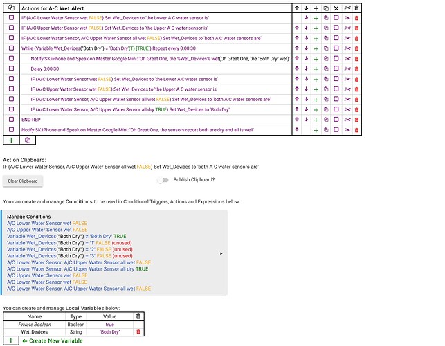

But one thing that is puzzling me is why the While line of:
While (Variable Wet_Devices("Both Dry") <> 'Both Dry'(T) [TRUE]) ... thinks that is true because as you can see in the variable section Wet_Devices is set to Both Dry.
I did a test run, and sure enough, it thought Wet_Devices <> Both Dry and sent me a notification. It wasn't until it looped through and set Wet_Devices to Both Dry in the 4th IF statement that it stopped.
I'm not sure how or why it worked, but I clicked on the right Both Dry (the one after the <> sign) and then when I clicked I was done with the actions it is now showing up properly:
