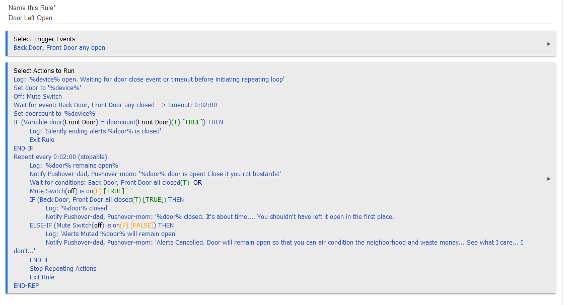

So here is my rule for a door left open. If goes into a loop if opened for more than 2 mins. I have a button (pico remote button) trip a virtual switch than when pressed stops the rule until the door is shut again. You could look at the button control portion and probably adapt it
that looks complicated, why can't I simply make a rule to stop a rule completely...
