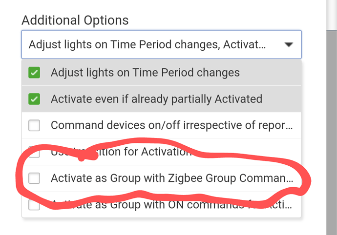

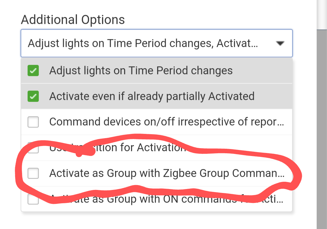

Would using RL and disabling the ZigBee Group Commands option resolve this? My understanding is that the hub would just send the commands to the individual devices vice trying to use the ZG commands.
EDIT: I had it backwards. You would just want to NOT have this option enabled.

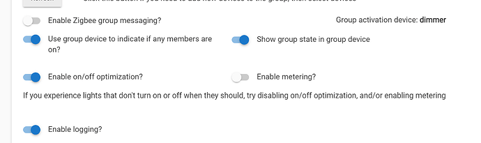

That suggestion gave me some progress! I disabled Zigbee Group Messaging in the Group and I can now execute a SetLevel on the Device page. Not yet working on the dashboard, but I am getting closer.

Thanks all for the help today, the key was to remove Zigbee Group Messaging and the rest I found from other posters! Awesome community!
