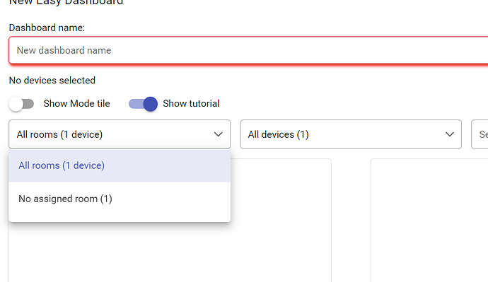

Add a couple zigbee devices just to get the ball rolling and while setting up a dashboard notice it says there are 3 devices.... doesn't seem right. I add the zwave dongle so I can scout out and hopefully find a ghost device. I see this list:
Now I have 3 devices, two zigbee and the zwave USB stick... when I go back into dashboard I see 4 devices now....
my device page shows this:

Thanks! Done all that and I'm still seeing that (4 devices) in the dashboard screen, as above. Reset both z-wave and zigbee. Only see three devices in the devices page and 4 devices listed in dashboard screen... so all still as above.

Not sure why you are using the dashboard to "see" devices? Are there devices in the devices page? If not then the (1) showing on that easy dashboard page is probably a bug, they are brand new.
What's brand new?
The zigbee reset keeps failing. I can recreate it often (not every time) using the reset zigbee button. The full reset is also failing with the same message. It states it's already registered after the 'full', that's what makes me think the full reset isn't working either (besides the zigbee reset failed message at the 'end' of the process).
I'm not really using the dashboard to 'see', more noticing one device 'listed' tho nothing shows below or in devices page... I'll call it a ghost device, just because it's not listed anywhere else. I'm maybe just paranoid based on chasing ghost devices/unreliable C-7's around for years now. Just want to make damn sure my db's are all clean and nice before I populate etc.
That original screen cap of the zwave tool listing shows a number of 'devices' below the #5, which as i understand it shouldn't be there on a brand new setup...
The "Easy Dashboard" is brand new with the 2.3.9 release. Thus, on a hub with no devices, it might possibly have a bug with the count of devices displayed.
In fact, I just tested this hypothesis on a Development Hub, and in the Easy Dashboard, I see one more device accounted for than actual devices on the hub.
Thus, nothing to worry about, IMHO.
The Easy Dashboard is new, exactly what I said.
