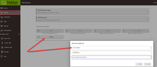

Along similar lines to @ogiewon 's, what if you created a two-button virtual button, one for on and one for off? Each button would only do the same action each time, so double-tapping the on button wouldn't change the state, since the physical switch is already on.

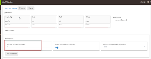

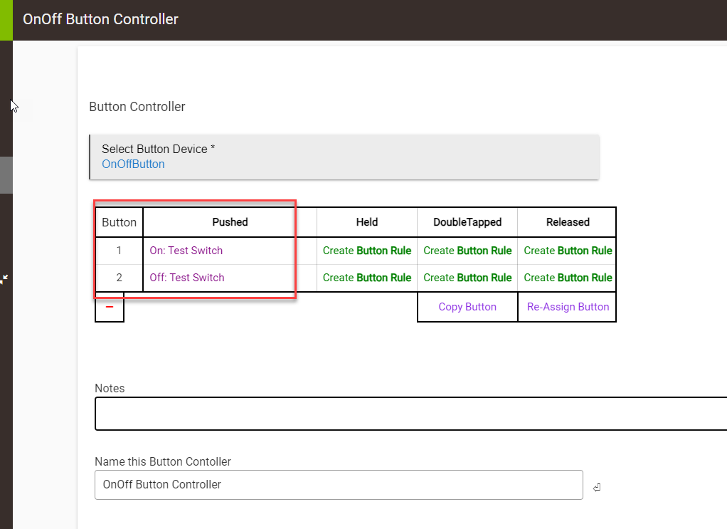

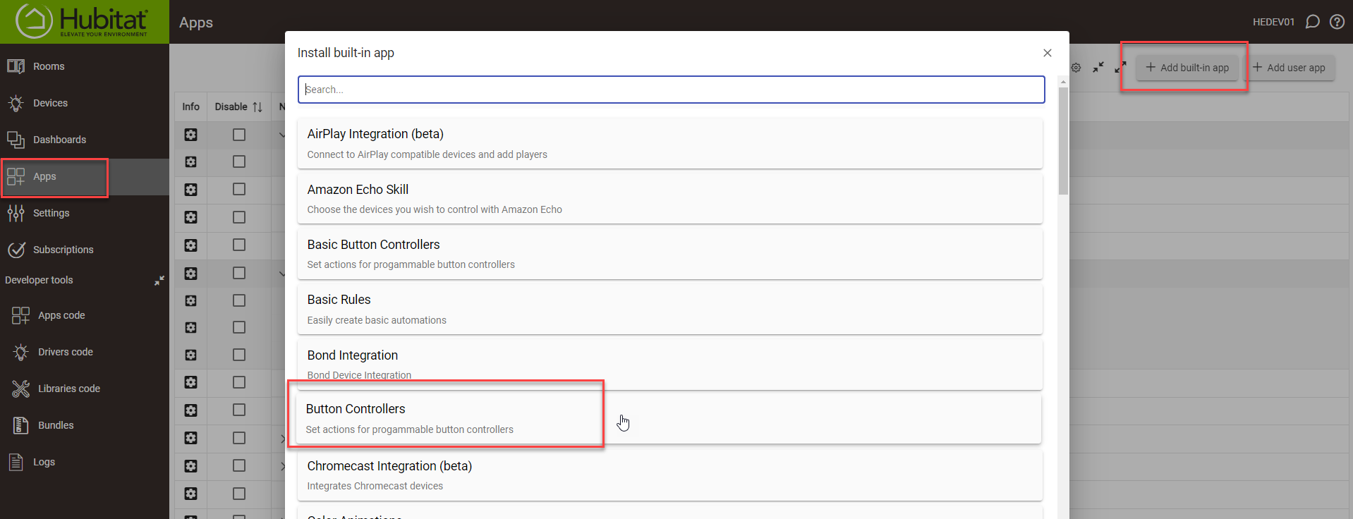

Create a new Button Controller, selecting the new Virtual Button created earlier. Create two "rules" for each of the two buttons, using a Control Switches action, button one push for ON and button two push for OFF.
