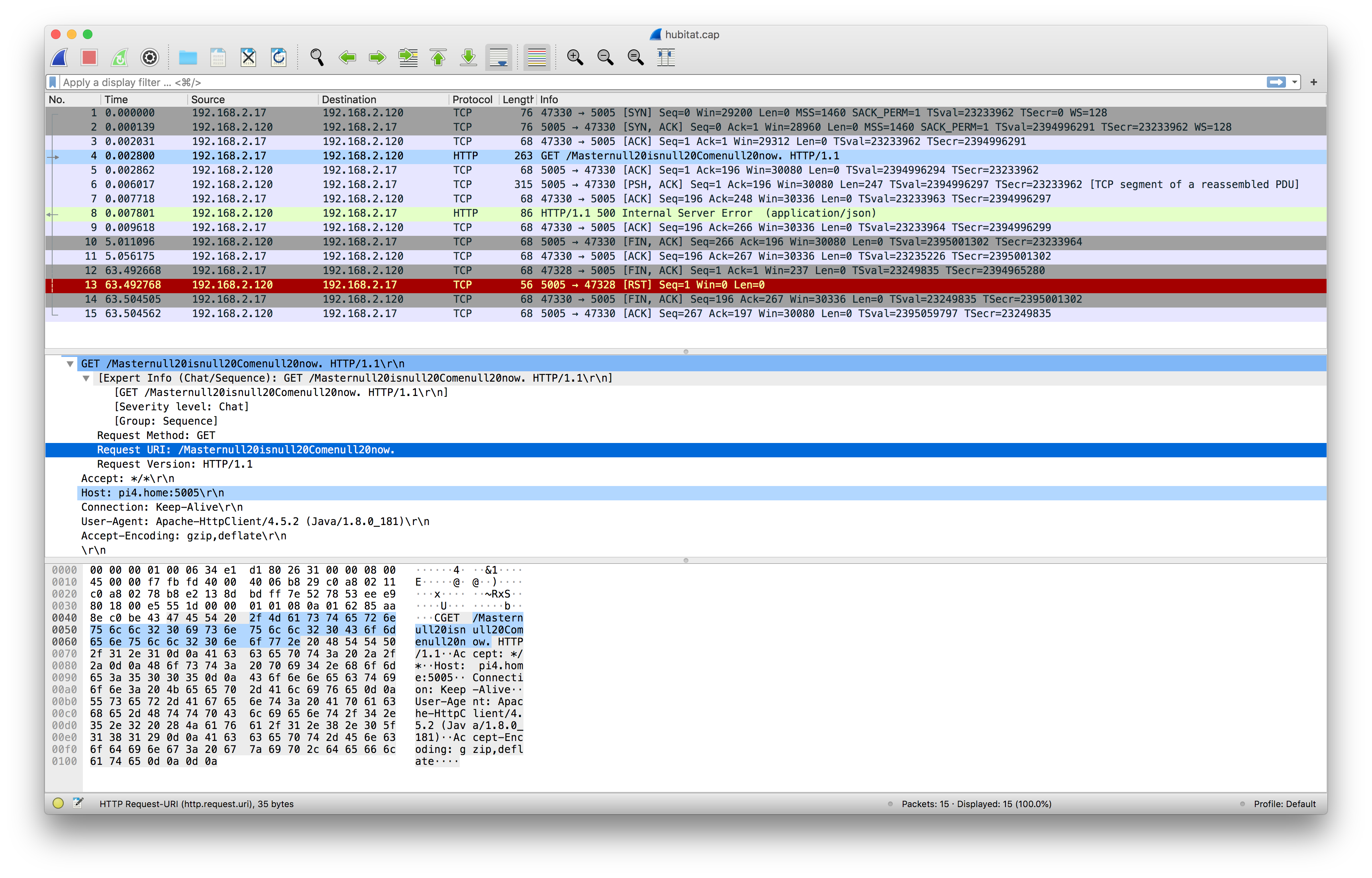

If I was troubleshooting, I'd use Wireshark to see what goes out on the wire and compare the data payloads between curl and HE requests and note any differences. Then go from there.

I'll edit the original URL, it changed when I renamed the favorite. If we're going to keep this thread as a the place to talk about the HTTP URL bug then let's focus on this URL which is valid, is an use case I have to have a "call to dinner" button in the kitchen, but doesn't work in Hubitat:
As for the bug, I'd expect a URL that curl accepts without an curl: (3) Illegal characters found in URL error to work in Hubitat.
Finally, I know how problematic URL handling can be. I've worked on HTTP clients in distributed systems and I found it almost impossible to get it right by "rolling my own" url library. With that said, the above URL is properly URL encoded, so I expect it to work:

There is a problem with URL encoding for URLs in RM. Unfortunately, the % character is overloaded in this context, and that is causing the problem. I will take a look at it.
Never put a URL encoded string directly into a URL field in Rule Machine. This is due to the use of % as a delimiter in RM for various things, including variable references.
If you want to put a URL encoded string into a URL in Rule Machine, put it in a String Variable at the time you create the variable, then use that variable in the URL field with %variable-name%.
