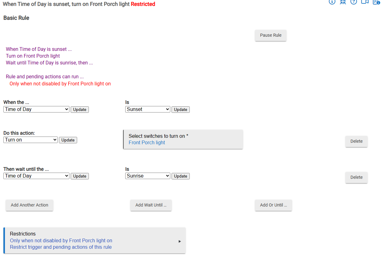

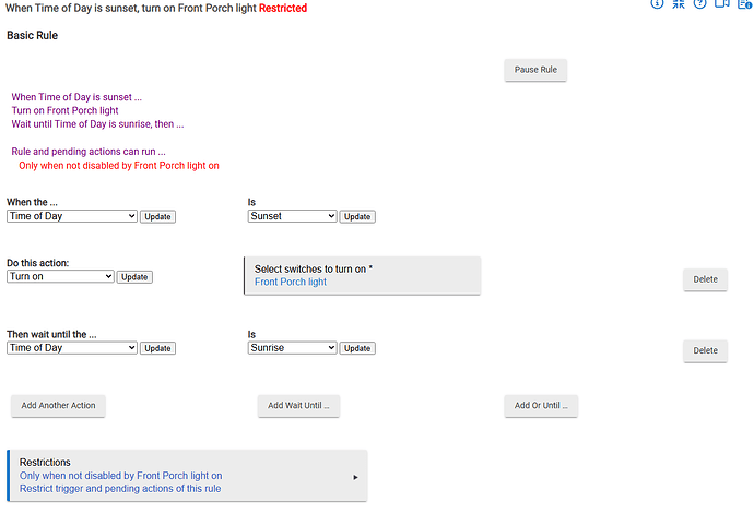

Also I’m not quite sure i understand the purpose of the restriction you added to your basic rule.
The rule turns the porch light on at sunset. But then the restriction will disable pending actions when the porch light is on.
So since the porch light will be on until sunrise, and the rule has been restricted from running since the light turned on at sunset, how will the light be able to turn off at sunrise?
As written, the restriction will prevent your rule from turning the light off at sunrise. And it doesn’t appear to do anything useful otherwise. What was your goal with that restriction while creating the rule?

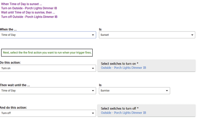

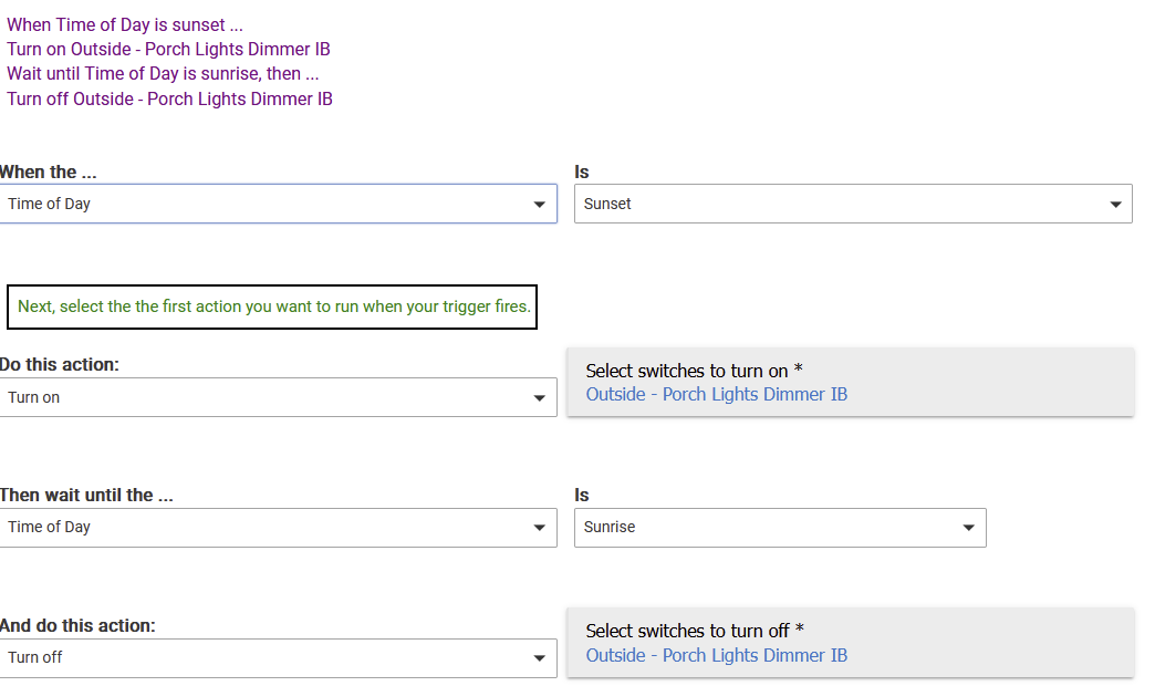

As has been noted already, it does not appear that you need the Restriction in your rule. The following rule is an example of turning ON a light switch at sunset, then turning that same switch OFF at sunrise.

It might also be worth re-stating (since it was pointed out above), that your last rule screenshot doesn’t appear to include an action to turn the front porch light off once sunrise has occurred.
This post: How to make a basic rule for sunset and sunrise - #10 by John_Land shows how to create an ON-at-sunset and OFF-at-sunrise Basic Rule for a single light switch. You can simply create a separate rule that looks the same but changes the light switch identification.
Alternatively, since it appears you want the front and back porch lights to go ON and OFF at exactly the same times, you can use a single rule and select BOTH switches in the ON and OFF actions (that is, in the blocks that say "Select switches to turn on" and "Select switches to turn off" -- note the plural, suggesting that more than one switch can be selected in those actions).
